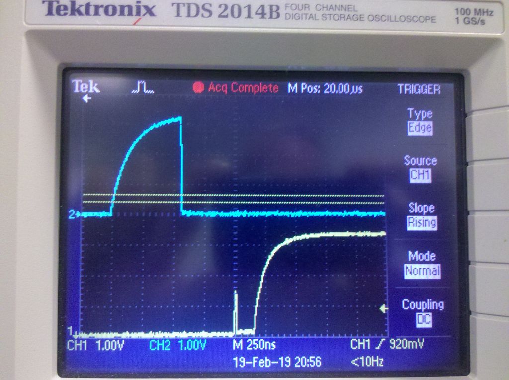

- With a bad UcD90120A this gives the I2C address 0x5C which corresponds to one bin below for both PMBUS_ADDR pins.
When measuring the voltage on the PMBUS_ADDR pins during initialization, the voltage on a OK device is 0.86V and on a bad only 0.73V.
This indicates that the 10µA (+-1µA) bias current source is at 8.6µA for a bad device which is out of spec.

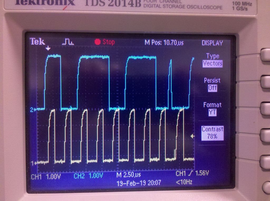

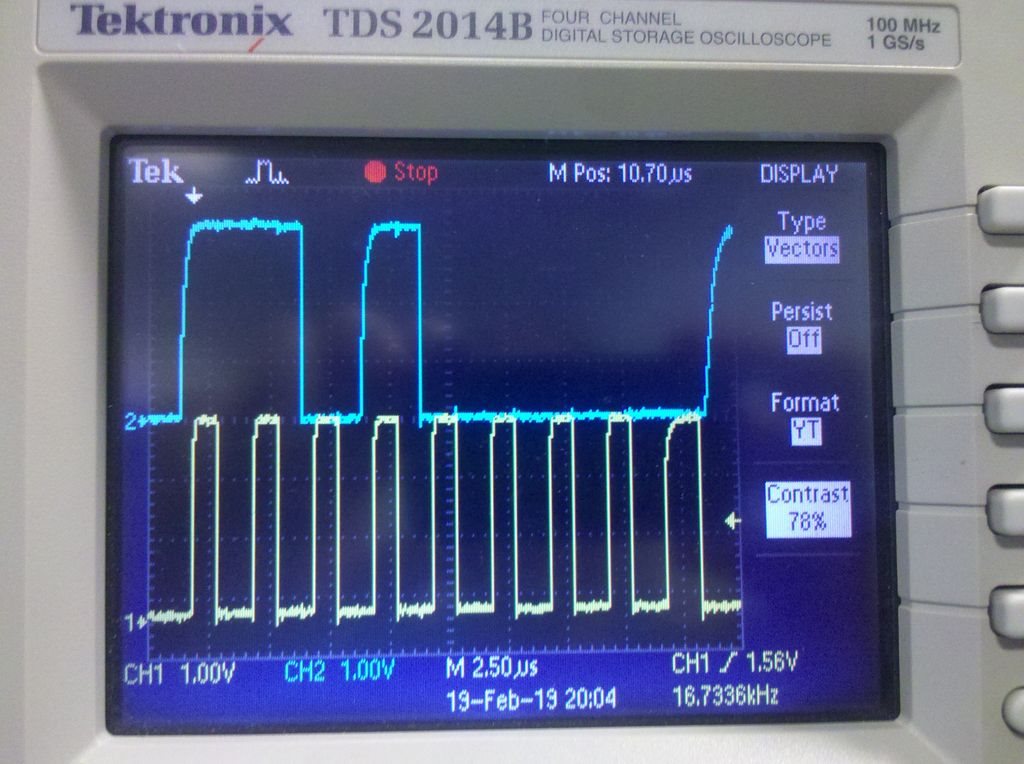

The EVM can communicate with the bad devices, but the I2C communication looks a bit different than for a good device:
On the bad devices, there is a short pulse on SDA just before the ACK and there can sometimes be seen a spike on SCK 0.5µs after the pulse on SDA:
(This spike messes with the I2C controller on our board which detects clock stretching. On the EVM, the T(SCK,low) is a bit longer (1.5µs vs. 1.25µs) and the 150ns low just after the spike barely hits the clock pulse)
Zoomed in:
And a good device for reference:
These observations could indicate that some calibration (PMBUS_ADDR bias current and I2C timing) of the UcD90120A could be corrupted when programming the configuration via JTAG.

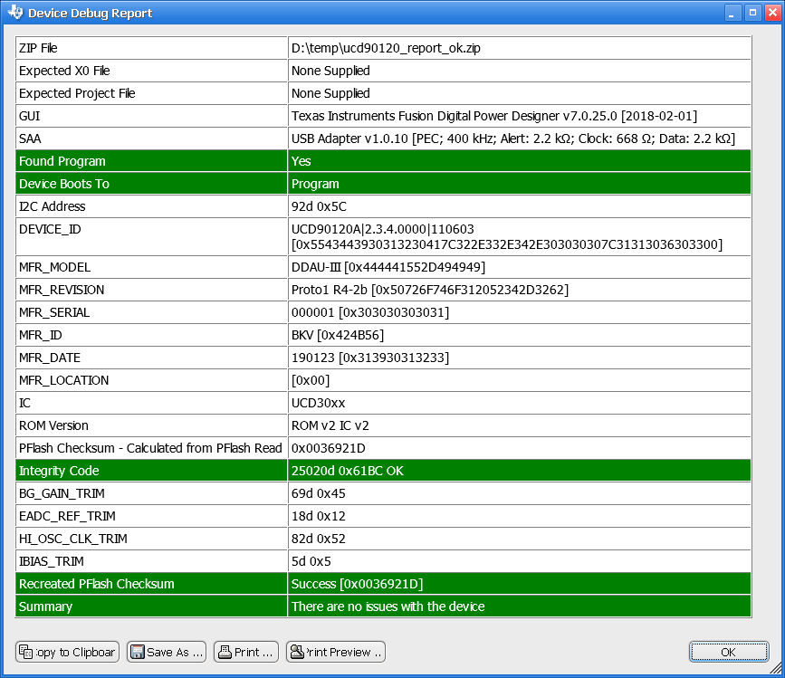

    please run the UCD Device Debug Tool on the unit and the report will tell you whether trim is good or bad. you can also share the report if you can not parse it.
    Yihe
  • Ok,
    The UCD Device Debug Tool reports that a bad device have Invalid Integrity Code (0xFFFF) and all the trims are at max. (0x7F, 0x3F, 0x7F and 0x7).
    And a good device is 0x61BC, 0x45, 0x12, 0x52 and 0x5.
    This explains the problems I see.
    I guess I can't fix the bad devices as they are individually trimmed. Correct?
