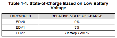

I understand EDV2 threshold can be set by parameter of "Battery Low %".
*Default value of "Battery Low %" is 7%.
I beleive 7%(default) is recommended however could you tell me what situation it should be set another value?

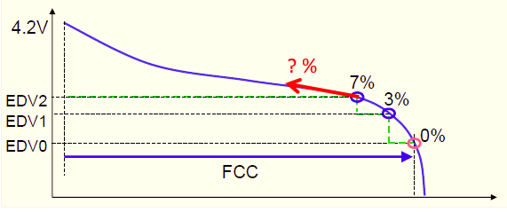

  • Hi Yaita
    We wouldn't recommend changing that value except if the 7% does not fall close to the knee region of the OCV curve. Those values are chosen to ensure the cell is below the knee region.

    My customer changed Battery Low% from 7%(default) to 80%, then he found RSOC doesn't decrease from 99% although battery is discharging.
    Do you know if it is expected behavior for BQ27320?
    The background of setting Battery Low% to 80% is he just wants to update FCC at battery voltage is around 3.55V.
    Yaita
  • Hi Yaita,
    I am sorry i was mistaken. I thought this gauge was like our other IT gauges where battery low is just a point that is set where the gauge will just indicate that the battery is low. This is totally different in this gauge. I looked at the TRM and it is indeed used for FCC learning. Your customer definitely not set that value to 80%. Does 3.55V correspond to 80% SOC on your device?

  • Hi Yaita
    So the idea for the gauge to learn FCC is that you need to be around the knee region of the OCV of the cell. Your battery low can't be higher than that.
