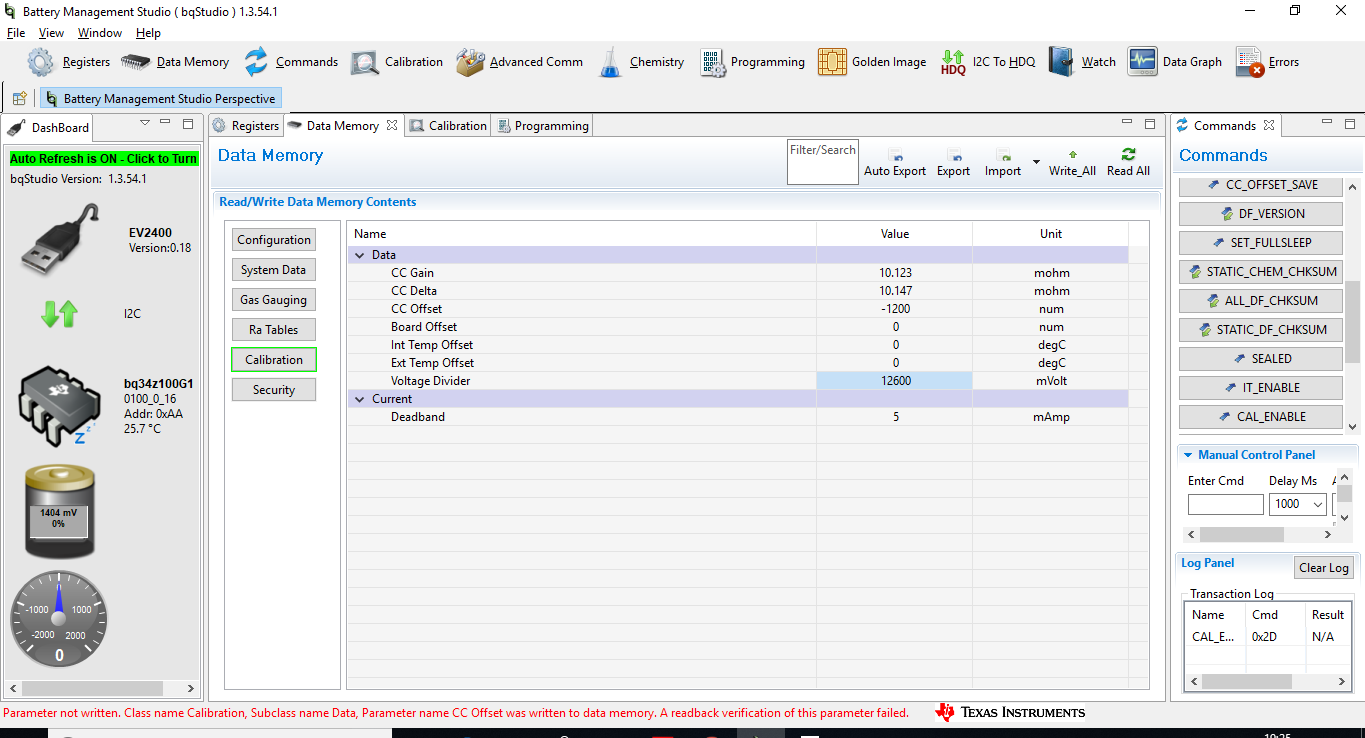

Hello Team,
I had connected the BQ34Z100EVM as per the guidelines shared in User Guide with all latest firmware versions. I am using a 12.6V battery (2600mAh) battery pack-3s mode.

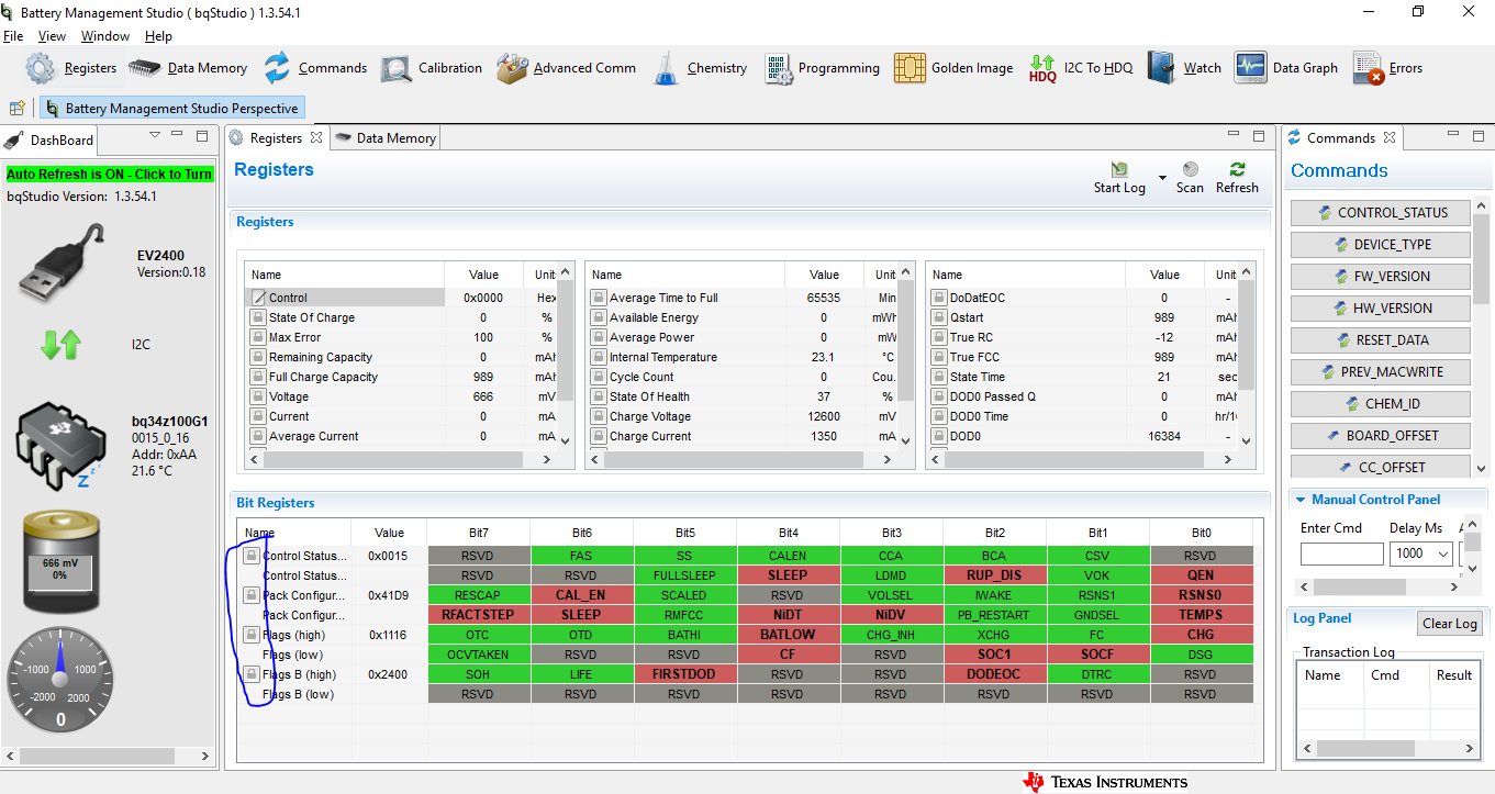

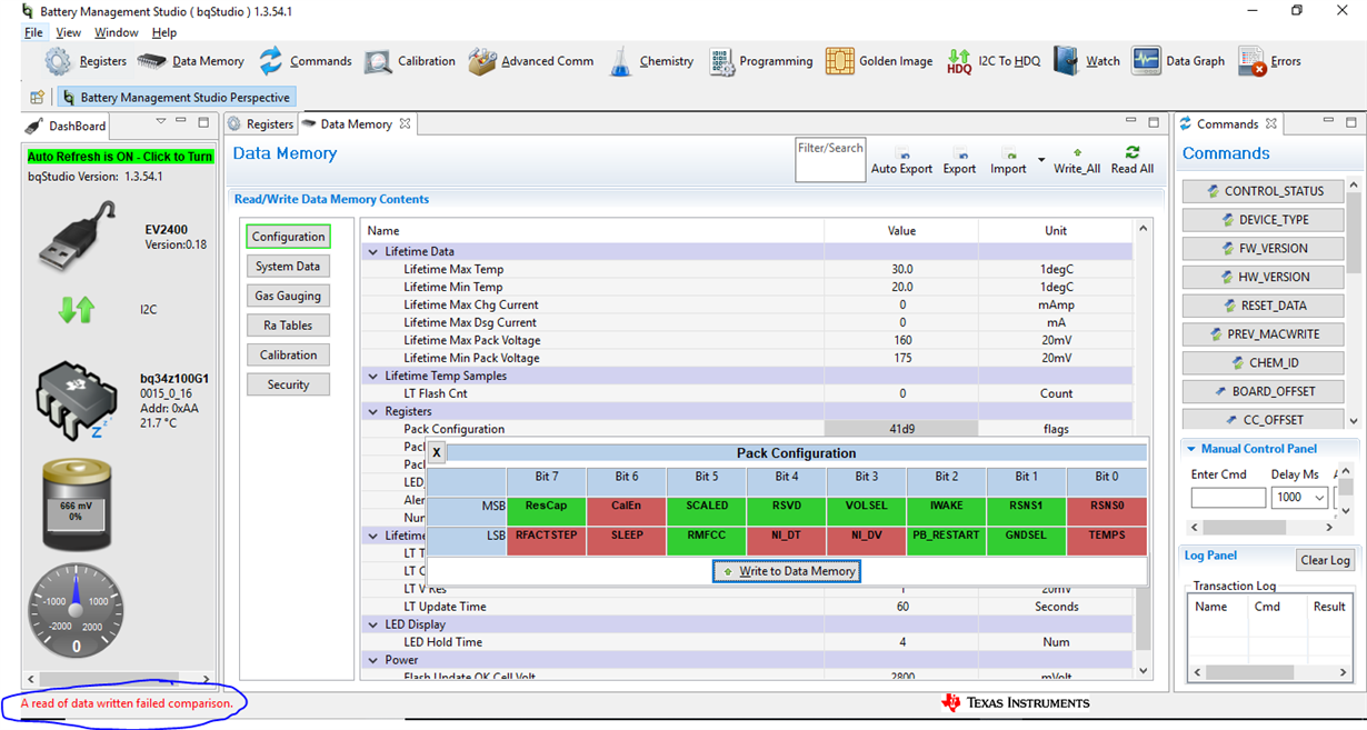

After Connecting the EV2400 and BQ34z100EVM using i2c cable, I clicked on UNSEAL mode to make the device in UNSEAL mode in command window on right side.But I am not able to verify if the same has been implemented as I am not able to change the registers. I am always getting error saying " READ OF DATA WRITTEN FAILED COMPARISON". I am not able to make VOLSEL as 1 to configure it for external battery mode. Can someone please help me with this on how to configure these things and fix asap
Also the registers are showing in LOCK condition .
Also the registers are showing in LOCK condition.
