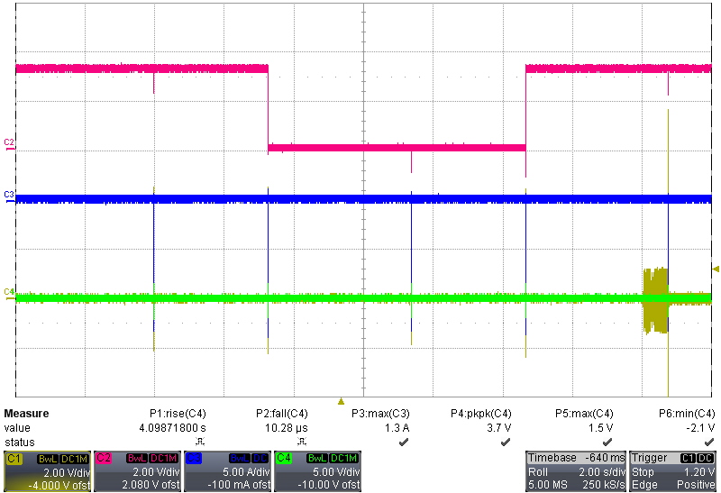

If disable the anlog compartor of C(Vout UVP), the module can start up after the over current occur lots of times. why? And I use debug i/o for see the fault if always happen. But the debug i/o only change sometime. And the wave is as follow:(ch2:debug i/o ch3: current) If the debug i/o change happen, it express that the flaut have been detected.

    I use debug i/o to see if the fault happen. you can see the picture. Why the debug i/o is not change every time?
  • Again, the answer is the same - something along the chain to that point is broken.
