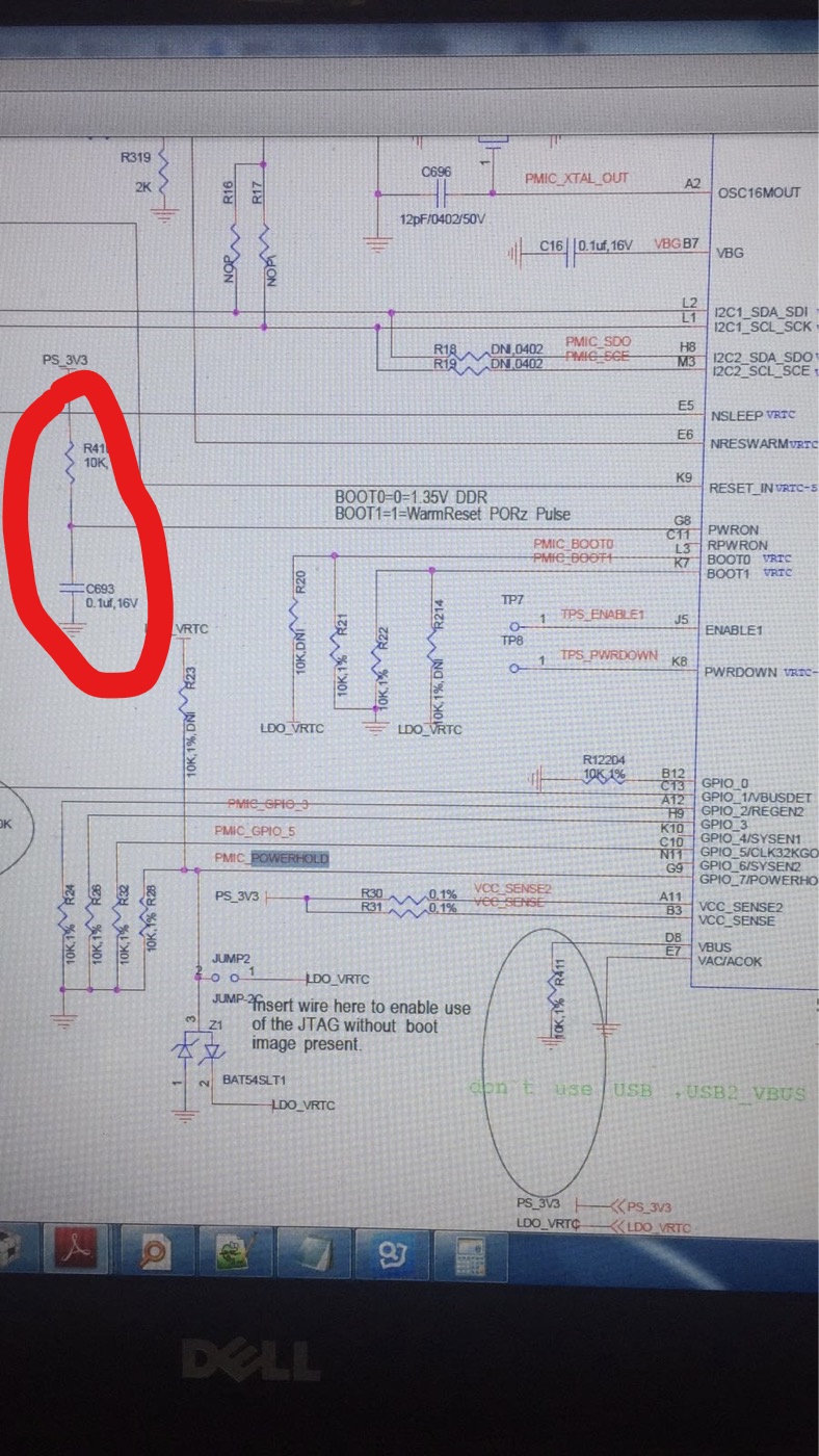

  • Hi, Nastasha,
    Still have two questions:
    1. Can we use the sch as followed to power up the TPS659037?
    2. If we need a external Low Level Signal to trig the PWRON pin, how about the pulse width for the low voltage level?
  • Can we floating the PWRON PIN without using the PWRON function?
  • hi,
    If you don't want to use PWRON, you can leave it floating. having a pullup on PWRON will not turn the device on since it needs a high to low level transition on PWRON to enable the PMIC.
    The other option to turn on the PMIC is to use an enable signal on GPIO_7 (POWERHOLD). When this GPIO is high the device will be on, when it is set low, the device will power off.
    Nastasha
