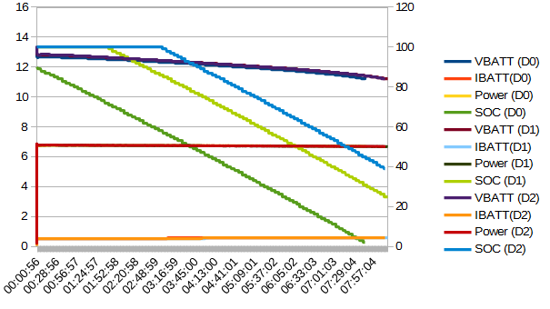

We have a burn in process for all the products manufactured. In particular, this product is taken through 4 cycles or discharge / charge starting with discharge. After each discharge, the batteries are charged for a minimum of 8 hours. Lately what we have observed is that as we progress in the burn-in the battery voltage and SOC goes out of synchronization. Results of first three discharge cycles are given below (of course, the first discharge cycle does not start from a fully charged condition).
Cycle VBATT SOC
0 11.19 2
1 11.19 25
2 11.19 39
As you can see, the SOC value corresponding to the terminal voltage increases as we proceed with the burn in. Due to this we are unable to guarantee a fixed usage time once the low battery warning is issued and in most cases the low battery message itself is not shown (as in cycle 3, because SOC is still >30 even when the unit is about to switch off).
Chart below shows the discharge characteristics from three cycles.
As you can see, the progression of battery voltage, current or power remains the same in all three iterations. However the SOC value stays at 100% for 1 hour 41 minutes for the second discharge cycle and 2 hours 58 minutes for the second cycle.

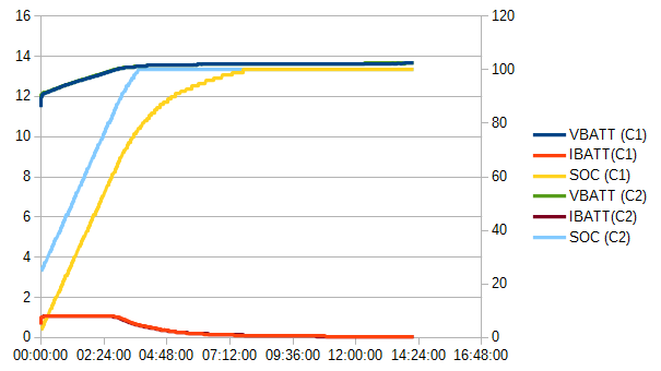

Charging characteristics are as below.
Rate of climb of SOC during first charging cycle appears quite ideal where 80% is achieved in about 4 hours (as we had characterized earlier). However the second charging cycle starts charging at a higher SOC level though it corresponds to the SOC at which the previous discharge cycle completed. Battery charger is based on BQ24450.
