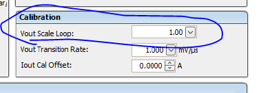

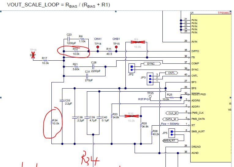

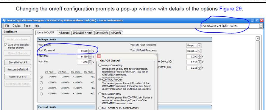

Hi team,
why the EVM default setting of TPS546C23 Vout_scale_loop is 1, based on the datasheet, it should be 0.5.Could you please help check it? Thanks.
