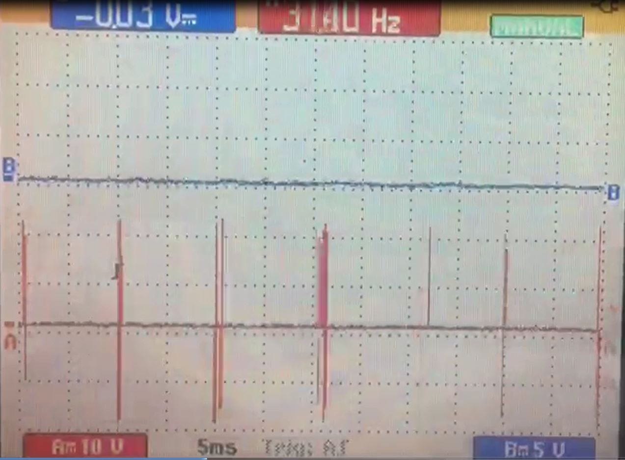

We have made prototype of 27V/20A SMPS using UCC256302.
In burst mode we are getting sound from transformer like..TIK   TIK   TIK   TIK . Repetative burst is at every 20ms.
After 0.44amp. burst mode ends and sound also disappears, thereafter upto 20amps. there is no noise from transformer.
Transformer details is as below,
core: PQ3535
Primary Turns: 24
Secondary Turns : 3+3
Auxilary secondary Turns : 2
Lm: 400uH and
Lr: 9uH
External series inductor : 30uH.
What can be the reason for this sound??
