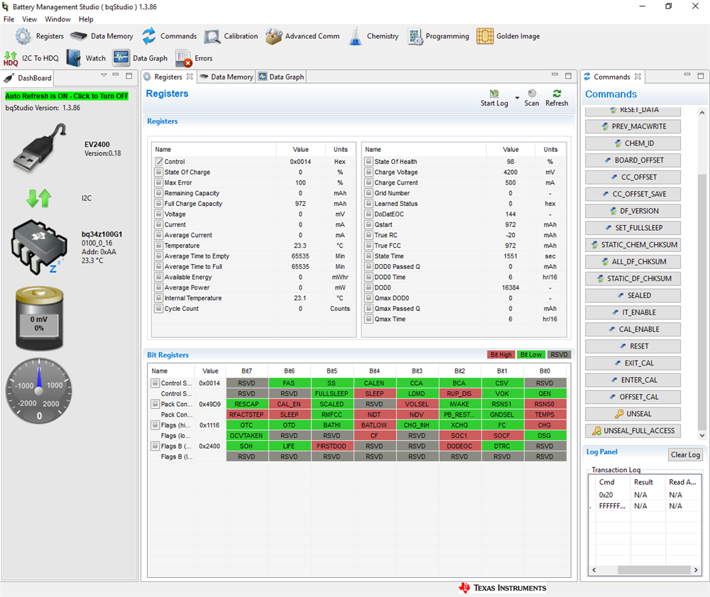

I have a BQ34z100EVM which I want to Reset. If my understanding is correct, I need to unseal the device before resetting it. I used the UNSEAL key using the button in the 'Commands' window on the right side of the BQstudio home screen. Upon doing this, I received the code as '36720414' in the column 'Cmd' in the 'Log Panel' below the 'Commands' window (I've attached a picture of the home screen with the code below). Next, I used the 'Advanced Comm I2C' panel to feed the unseal key. Foll. are the parameters I entered: I2C address: AA; Start Register Address: 00; Bytes to Write: 72 36 14 04. However, the device is not acknowledging this write operation. What are the mistakes in my procedure? Is there another way to unseal the device or reset it directly? Thanks!

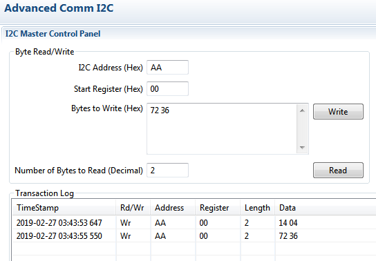

    Turn off auto refresh (green bar at the top of dashboard should now be red)
    In Advanced comm send
    14 04 then 72 36
    To do this quickly, copy 72 36 into the clipboard of your machine, then type in 14 04, click write, highlight 14 04, ctrl-v to paste, click write
    Images below:
    Sincerely,
    Bryan Kahler

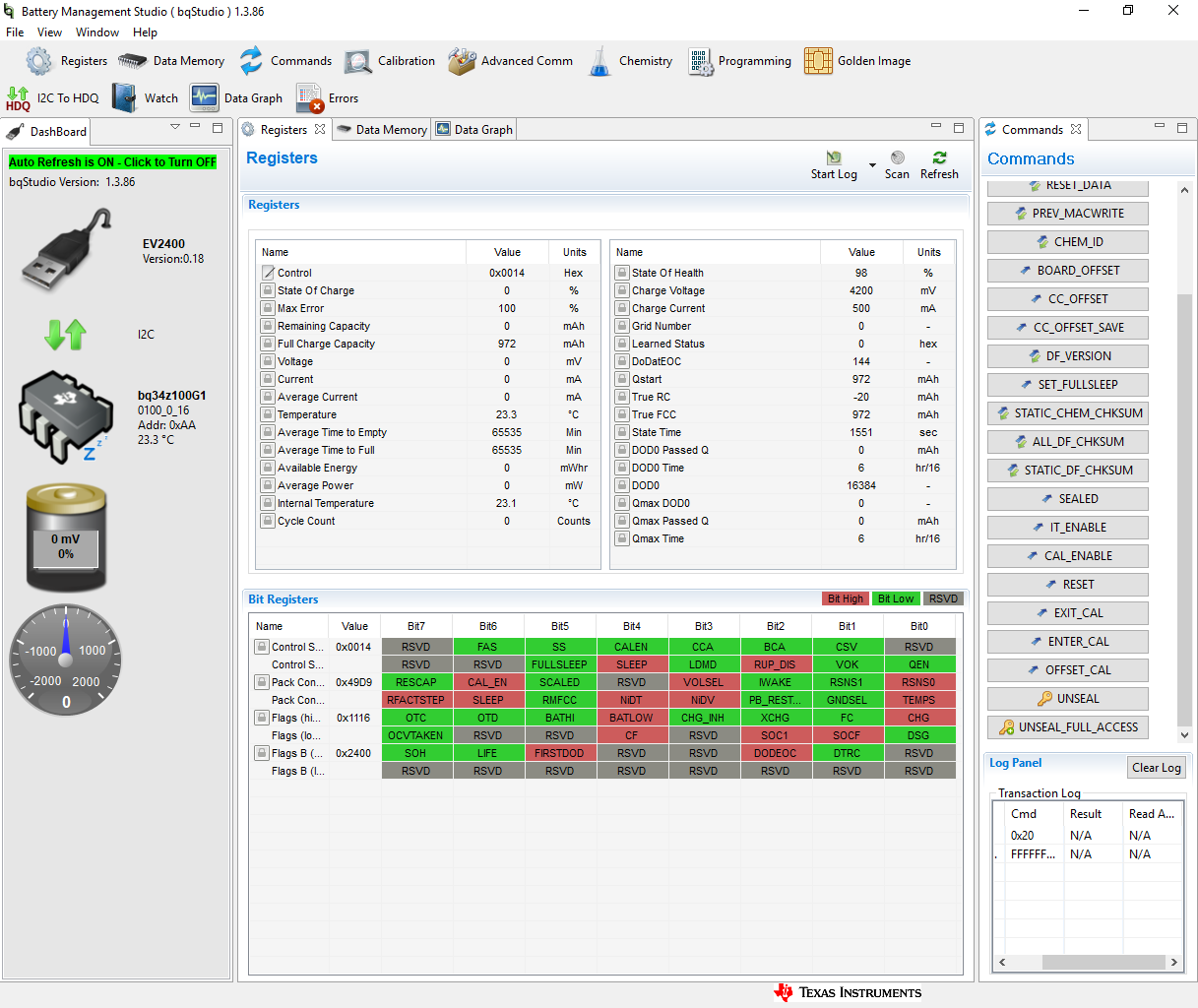

    The jumpers are set to <=5 V; VOLSEL=0. The voltage divider was set to 5005 mV, hence I reset it to 5000 mV. However, still the gauge voltage reads 0 mV (even after I refreshed the REGISTERS window) whereas the power supply I've connected is set to 4V.
    The FLASH UPDATE OK VOLTAGE is 2800 mV and NUMBER OF SERIES CELLS is 1.
    I didn't reprogram the IC, but currently my REGIN voltage is 4.03 V (measured on the TP6 pin).
    I've attached a picture of the REGISTERS window beneath:
    P.S.: When I obtain Full access to the device, there appears a 'Zzz' sign next to the IC in the DASHBOARD. Is this okay, or does it mean that the IC is inactive or something?
  • Hi Ved,
    For this device, the Zzz icon indicates that the device is unsealed and unsealed full access.
    If either of the lock icons were in front of the gauge, commands may not work until unsealed or unsealed full access.
    Please try power cycling the gauge to see if this fixes the issue.
    After power cycling, check to see what value is set for voltage divider. If the issues persist, please program the gauge with the SREC found on the website, here: www.ti.com/.../sluubv2
    Then, follow the bringup steps in the quick start guide, found here (it appears they have all been followed): www.ti.com/.../sluc580
    If the issue still persists, measure the voltage on the BAT pin and let me know the results.
    Sincerely,
    Bryan Kahler
