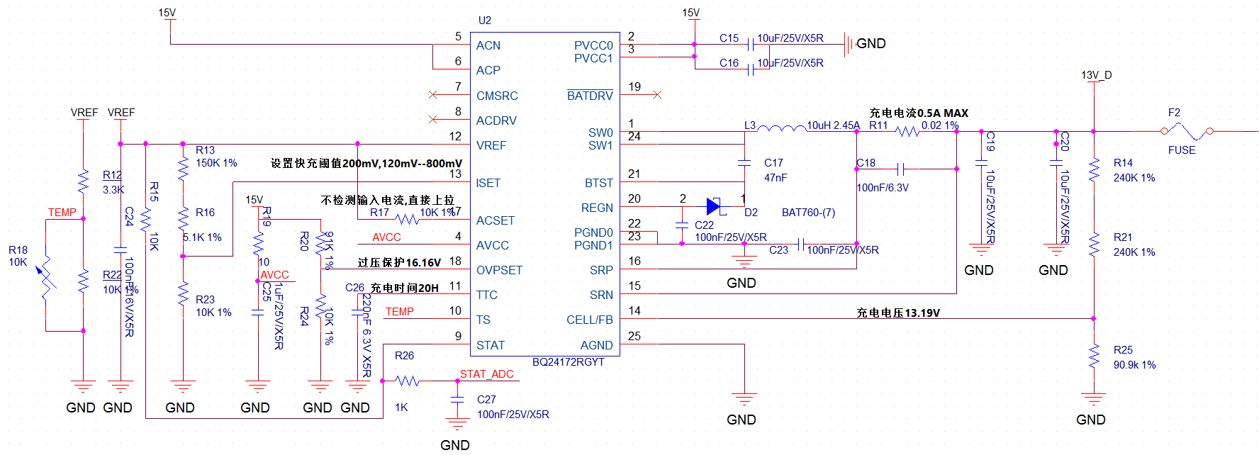

BQ24172: Will TTC pin influence battery absent status?
Part Number: BQ24172
Hi team,
My customer used BQ24172, they want to get battery absent status by STAT pin. When connecting a capacitor to TTC pin, STAT will blink with battery removal. But when connecting TCC pin to GND, it will not blink. Will TTC pin influence the battery absent status? Thanks.
