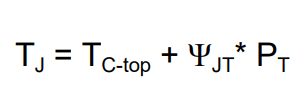

Would you tell me the maximum junction temp(Tj max) for TPS3838L30DBVR.
My customer hope to know this value for thermal simulation.
The device was defined for max, normal ambient temperature of +85degC.
The junction temperature can be estimated by the following equation below.
You can see as if the total power consumed by the deviced (P_T), is in the low microwatt or nanonwatt, then the second term of the equation below is zero and the T_J = T_C-top = T_A
Hopefully this helps.
Thermals resource:www.ti.com/.../slua844a.pdf
