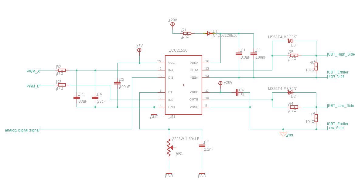

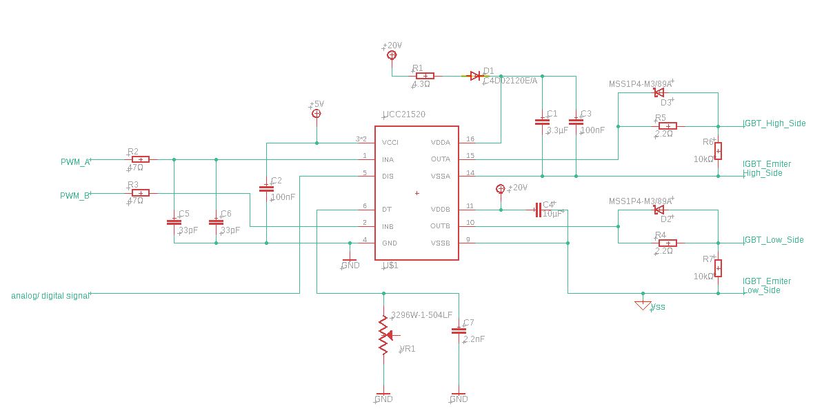

  • Hello John
    Thank you for the help! I did some calculations and I added the circuit in this reply. The IGBT's I'm using are the BSM 150 GB 120 DN2 (datasheet: https://www.galco.com/techdoc/eupc/bsm150gb120dn2_dat.pdf)
    The switching frequency will be 16kHz, Vcc=5V, Vdd=20V and the HV DC-Link will be 600V. I think everything should work perfect, but it would always be nice if you could confirm that everything will work fine. Especially because it's my first time building a circuit and making my first PCB. Thanks in advance. If you need extra information I can always add it in this thread.
  • Hi Gauthier,
    Thanks for providing your schematic! That helps immensely.
    Some initial things on the primary side: I think C6 should be connected to PWM_B input instead of in parallel with C5. We recommend adding a 1nF capacitor close to the DIS pin (pin5) just to make sure noise on the high impedance net doesn't turn the device off. Make sure DT decoupling cap (C7) is located as close to the pin as practical.
    On the secondary side: It looks like the IGBTs you've selected can operate up to 20V Gate to Source, which means you will be operating right at the recommended max. This will probably be violated during switching transients which wouldn't be good. You can either lower this 20V supply, or you can go split supply and drive the IGBTs at something more like +15/-5, which is something we commonly see in our other customer's IGBT drive circuits. There are a couple different circuits to achieve this off a single rail 20V supply - Figure 39 in the datasheet gives a good initial design.
    Last thing: Is 16kHz a hard requirement? This will probably emit an audible high pitch noise. Going to 20 kHz would bring that sound out of the hearing range of most humans and is what we see in many of our customer designs. This also could help shrink inductor and capacitor sizes down the line.
    This is a very good initial schematic. Feel free to ask more questions!
    If this helped answer your question, could you please press the green button?
    Thanks and best regards,
    John

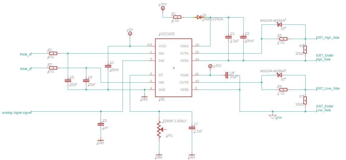

  • Hello John,
    Thank you for all the feedback you are providing! It is really appreciated!
    I considered some things you said in your previous reply. The capacitor C6 indeed was supposed to be connected to PWM_B I made this mistake while drawing the scheme probably. I have also added the 1nF capacitor at the DIS pin as you recommended.
    The voltage of 20V is indeed not perfect for the IGBT's so as you said I will drop the voltage to 15V instead. Do I have to change some components for this operating voltage? I think the boot capacitor should be smaller, but I'm not sure. I calculated the dimensions and the minimal capacitance should be 1.6µF. Can I still use the 3.3µF from my previous design or would it be better to take a capacitor with a smaller dimension?
    The operating frequency will probably stay at 16kHz, but can I work with the current design at 20kHz if I want? The inverter is for experimental purpose for my thesis so it would be nice to use the inverter on different switching frequencies. I added the modified scheme below in case you had extra remarks on it:
    Thanks in advance and thank you for all the help!
    Kind regards
    Gauthier
  • Hi Gauthier,
    Happy to help.
    The schematic looks pretty good now. If you wanted to run +15V/-5V on the output, you could keep the 20V input and generate the split supplies from this bias. Other than a split supply circuit, you shouldn't have to change anything to run at +15V only. Using 3.3uF should work well, it's just important to have the pads there if you need to modify it during your testing.
    It might be prudent to add a placeholder 0 ohm turn-off resistor in series with D2 and D3 so you can play with the output circuit's drive strength if needed. I've also seen the drive circuit reversed for IGBTs so there is a turn-on diode circuit instead of a turn-off diode circuit. 16 kHz should work, so no worries on that operating point.
