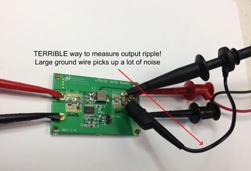

I'm using TPS54821 regulator in my project.  I have used TI WEB BENCH Simulator and implemented my design, wherein it is showing very less ripple value. But practically I'm getting 100mV. I need ripple to be less than 50mV.

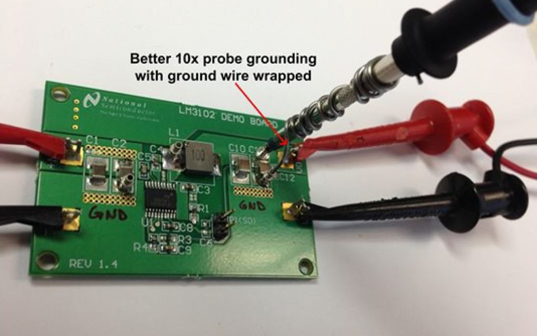

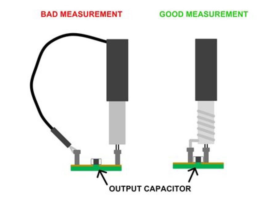

    From the test method side, use 20MHz bandwidth limit, put the probe exactly across the output cap, use small GND wire:
