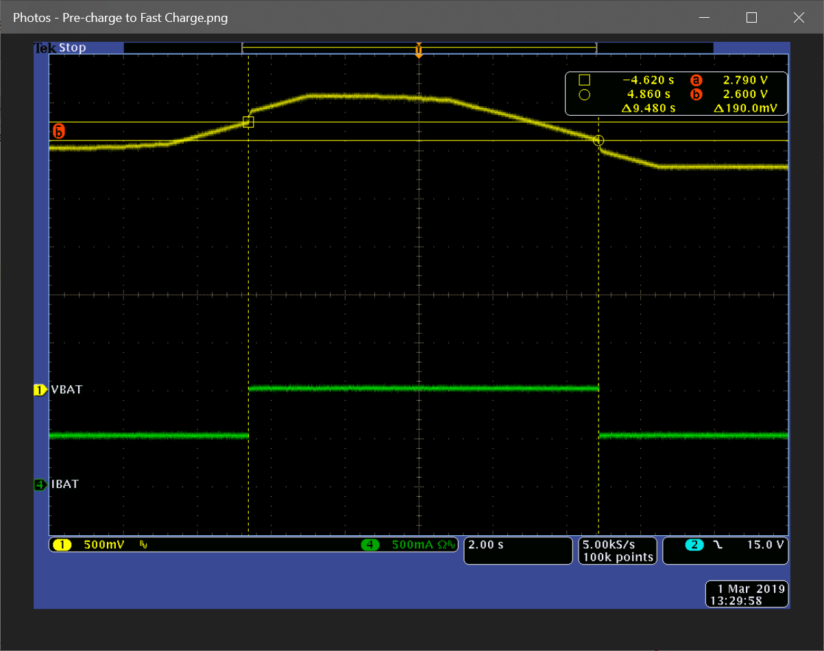

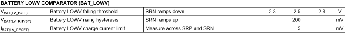

    Your battery voltage is only 2.6 V. However, for safety reasons, the BQ24780S does not apply the full fast charge current when the battery is at a low voltage. Instead, it applies a lower pre-charge current to safely charge the battery up to a voltage high enough for fast charge. This voltage threshold is called BAT_LOWV, as shown in the picture below.
    The waveform below illustrates this. My Charge Current register is set to 1024 mA, and you can see that the transition from 500 mA pre-charge to 1024 mA fast charge only occurs at around Vbat = 2.79 V when Vbat is rising and Vbat = 2.6 V when Vbat is falling. This is close to the datasheet's typical values of 2.7 V and 2.5 V, respectively.
    Since your battery voltage of 2.6 V is below the BAT_LOWV threshold, the BQ24780S is only applying pre-charge current, which is why your Ichg stays low for higher Charge Current register settings. No matter how high you set your Charge Current register, it won’t matter if your battery voltage is below BAT_LOWV because the Charge Current register only sets the fast charge current, not the pre-charge current.
    To fix this issue, you would just have to increase your battery voltage above BAT_LOWV, and then you'll be able to apply the full fast charge current.
