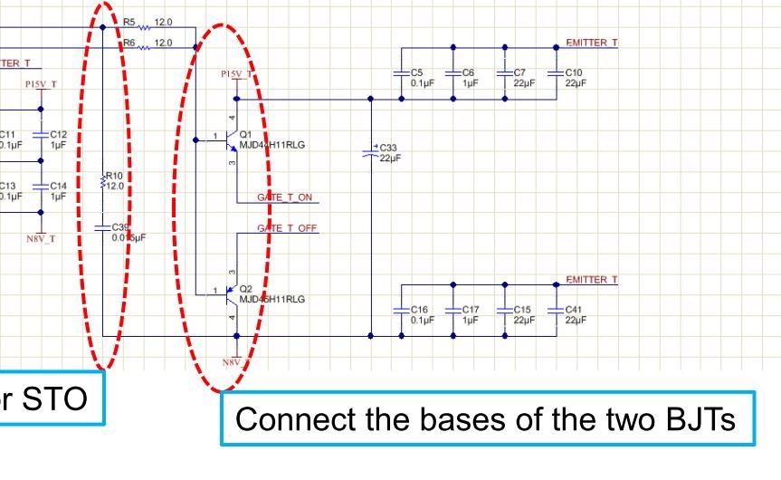

  • Hiii Audrey,
    I am developing a SIC gate driver with ISO5852s. I am using external current buffers FZT851 & FZT951. The turn on & turn off resistors are 3.9ohm, 3.9ohm, turn voltage is +15V, turn off is -5V . The Ciss of the SIC mosfet is 16nF , short circuit withstand time is <= 2us. Please help me to decide the R & C values of STO to get a soft turn off time of 1.5us.
  • Hi Naga,
    The ISO5452S has a low-level output current of 130-mA after a short-circuit condition. The capacitor is based on this current, thus you can calculate the value using the equation C=(t*I)/(VCC2-VEE2), where t is 1.5us, I is 130-mA and VCC2-VEE2 is 20V. Using these parameters, you'd find a value of C=9.75-nF. The value of the series resistor is based on the current level during normal turn-off operation, which is 5-A. Thus, R should be greater than (VCC2-VEE2)/I, so R must be at least (20V)/(5A)=4-ohms.

  • Hi Naga,
    Please refer to this attached app note where we achieve 3us of STO time on a 15nF load. This design uses R10=12-Ohms and C39=15nF. You may start with a set capacitor value (1-10nF) then tuning your resistance accordingly to achieve your 1.5us desired STO.
    Section 2.1.7 and 4.3 below discuss this in further detail.
    www.ti.com/.../tiduc70a.pdf
    Please let us know if you have further questions.
    -Mamadou

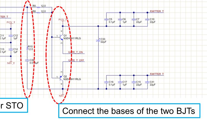

  • Why it is needed to connect the two bases ? why can’t we operate separately.
  • Hi Naga,
    If the IGBT module is directly connected to the gate driver IC, the gate charge of the IGBT is slowly discharged through the internal current sink of the Isolator during turnoff.
    The BJT buffers (between the driver and IGBT) help increase the IGBT gate drive current therefore in the event of a short circuit, you need to provide the soft turnoff of the device and that must be done directly at the driver's output which are connected to the base of the transistor pairs.
    -Mamadou
  • I think you have not understood my question. In the image that I have attached above, mentioned to connect the bases of the pnp, npn. Here my question is it mandatory to connect the bases?
    Can we operate the circuit without connecting the bases?
  • Hi Naga,
    My apologies, You're correct I misunderstood your question.
    To answer your question, yes, you must connect both bases of the pnp-npn pairs to configure as non-inverter buffer for the BJT buffer to achieve the desired increase drive current. Both bases connected would then be connected to the split output OUTL and OUTH through resistors.
    We do not recommend connecting one base to OUTL and the other base to OUTH or using inverting current buffers as desaturation fault protection will not be compatible with this configuration.
    I hope this answered your question. If it did, please press green button or let us know if you have further concerns.
