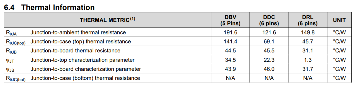

TLV62568: thermal information for different package
Part Number: TLV62568
I have a question about the thermal information in different package, in the below picture:
I wan to know why the DBV thermal resistance is higher than DDC and DRL, but the size of DBV is bigger than DRL, why the size bigger while the thermal resistance is high.
could you help on it? thanks.
