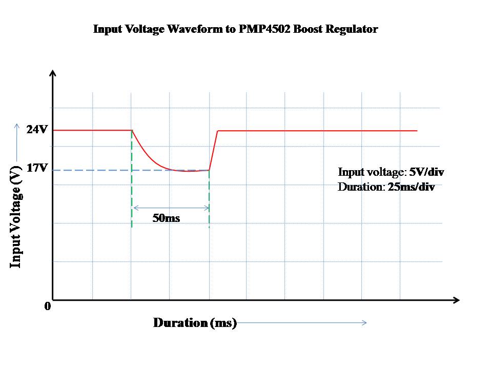

  • Dear Youhao,
    Thank you so much for the support.
    We need to support the below input waveform for PMP4502 circuitry.
    We need to know exact modification in the current circuitry of PMP4502 (24V to 48V boost converter) to meet the above input voltage requirement (30% voltage dip for 50ms).
    The output voltage requirement in above case is 48V @ 350mA.
    Please let us know whether the above input requirement can be supported in PMP4502 design with exact change details at the earliest.
    Thanks and Regards,
    Nibin
  • Hi Nibin,
    This 17V is less than the 19V that you mentioned earlier. What is real, the 17V or 19V?
    The 50ms is almost a dc condition for the circuit switched at a few hundred KHz. If this is true, your circuit must guarantee operation with 17V input.
    The ref design supports 1A@48V load with 24Vin. When your load drops to 0.35A, the original design should support your full load at 17Vin. My previous concern of possible tripping the peak current limit was under the assumption of 1A load.
    Youhao
  • Dear Youhao,
    Thank you so much for the quick response.
    Our customer is requesting for the design support of 30% input voltage drop. So considering 24V as normal voltage, the 30% dip will be around 17V.
    Now we understood that the output of the boost regulator (PMP4502) will give proper output 48V for the 30% input voltage drop occurs for 50ms.
    If the input voltage drop to PMP4502 circuitry is 60% drop (9.6V), whether the output 48V will be present? Customer is expecting the OFF of POE circuitry at this condition.
    Is it correct?
    Awaiting your valuable response.
    Thanks and Regards,
    Nibin
    Nibin
  • Hi Nibin,
    At 9.6V I am afraid the circuit may be still be operating but it just be unable to support the full power because of the peak current limit. There is not UVLO control in the PMP design. If you want to turn of the device, you should consider to use a LMV431 or TLV431 to monitor the input voltage by setting a threshold voltage, and use the LMV431/TLV431's cathod to control the SD pin. There should be a pull up from the input line to the cathode through a large resistor (>20k). Thus, when Vin is below the threshold, the LMV431 cathod would be open, and the pull up will set SD pin high potential, and the TPS40210 will stop switch.
