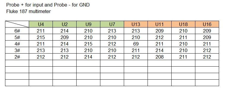

  • Hi Mamadou,
    Please see below picture for test data, I record only the integer part of the reading. I am not very clear when the input resistance changed, so I measured all the PCB boards on hand for tracking.
  • Above test result is with the UCC27531 soldered on PCB board.

    Looking at your measurement table though, most of your measurements seems to fall within the +/-20% variation except U13 on one measurement.
    Can you please retake the measurement on U13 again while soldered on and off your board to confirm.
