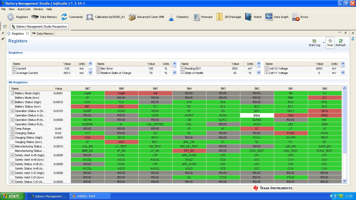

    10 cells setup with the BQ76930EVM,
    OCC threshold setting -10000mA, delay 6sec.
   ASCDL, ASCD, AOLDL, AOLD, OCDL, AFE_OVRD    -----   all disable
   every time load current over 8A, DCHG FET turn off, all other bit registers remain the same.
   sometime loading spark cause same problem, It seem cause by short circuit protection,  How can I figure it out ?
Best Regards!
Andrew

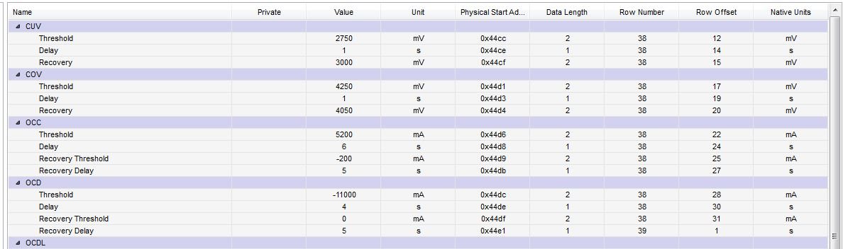

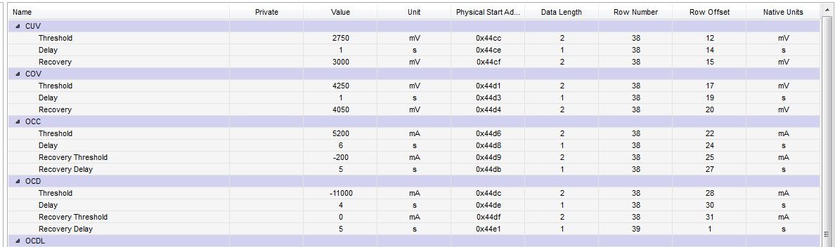

    I am a little confused. I loaded the file you sent and it looks like the OCC protection is set to 5200mA (instead of 10000mA). Is this correct?
  • Hi Matt,
    Sorry , my typing error, I mean OCD, all the problem now is discharge cut off below OCD setting, register also not show why it cutoff.
    OCC mean Over Current Change, right? I don’t think this setting will cause my discharge cut off problem.
    You can see , during this test, my OCD threshold setting -11000mA.

    I check your settings and I tested with these settings on an EVM. I am not able to repeat this case. If I go over the OCD threshold, the 'XDSG' and 'OCD' bits go high in the Registers and the DSG FET is disabled. If I take the current back to a lower value, the FET turns back on and the other bits return to their normal state.

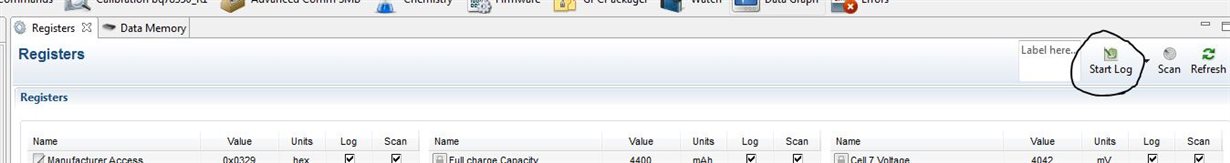

    Can you capture a log file of this event? To capture a log file, click on the 'Start Log' button on the top of the Registers page:

    Ok, I see the files now. The logs files don't show any reason for the DSG FET to turn off.
    One possibility is that the BQ76930 fault protection is disabling the DSG FET. You disabled ASCDL, ASCD, AOLDL, AOLD, OCDL, AFE_OVRD. but detection of AOLD and ASCD cannot be disabled. The threshold is configured by the BQ78350-R1 (see the AOLD Threshold setting). I am not sure why the FET is not getting enabled again after the fault clears though.
    Your setting for AOLD is 61mV. If there is 61mV detected across the sense resistor, the DSG FET will open.
