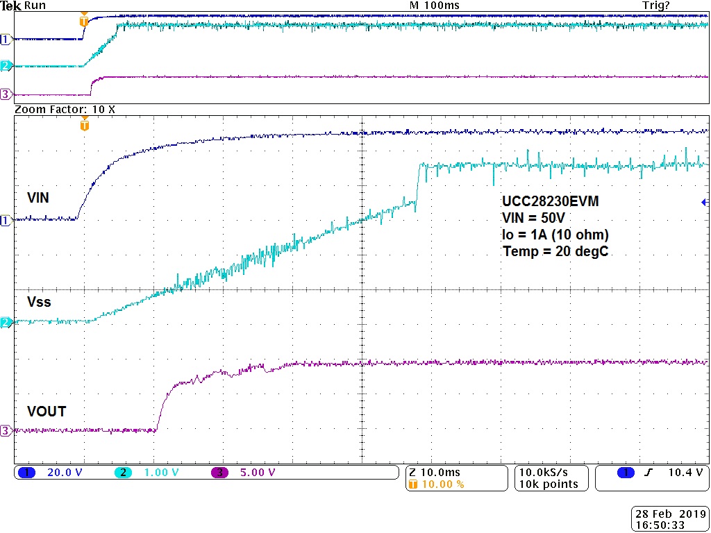

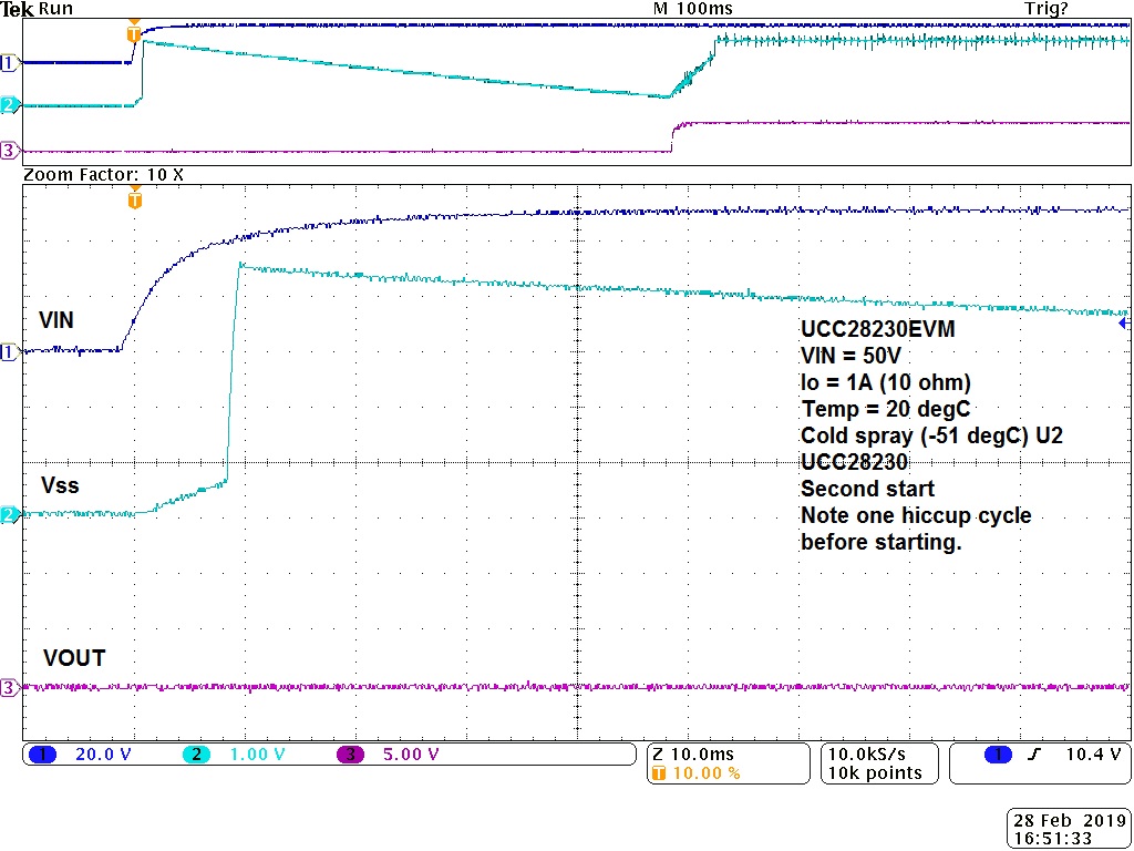

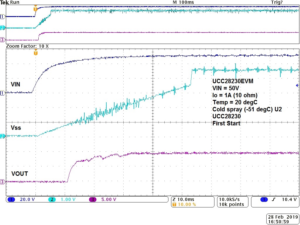

Testing with the UCC28230EVM has shown that startup time is significantly increased at cold temperatures (<20degC).  If power is cycled after the initial startup a hiccup cycle in initiated which increases the time from application of input power to output starting (see plots below).  This has been verified on multiple date code parts.
  • What is the cause of the hiccup cycle during startup at cold?
  • How can this be eliminated?  Startup time requirements cannot be met at cold temperatures.
Plot 1: Normal startup at room temperature
Plot 2: Normal "first" startup after cold spay (-51degC) on UCC28230
Plot 3: Delayed startup after cold spray (-51degC) on UCC28230
