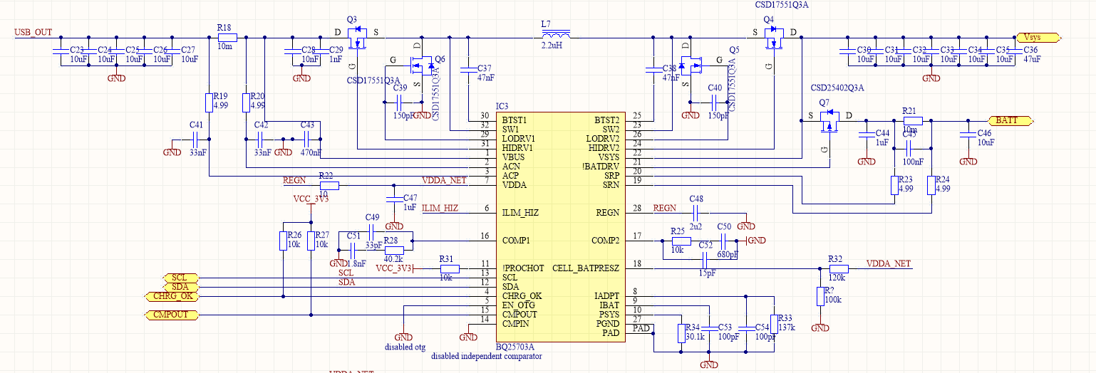

I have problem with charging 2S Li-Ion pack with BQ25703A. Let me describe my circuit. It is based on EVM module. No significant changes just simplified a bit the input protection.

    The only thing I can think of when looking back at your schematic is checking the CELL_BATPRESZ voltage. From what I can see, there is a 100-kOhm resistor pulled to ground but the component does not have a designator assigned, just "R?" What is this component placed?
    This charger uses CELL_BATPRESZ to determine if a battery is present and will stop charging otherwise.
    Joel H
    CELL_BATPRESZ stays at 2.7v no major difference between PSU and just battery supply.
    Changed ILIM_HIZ to 3.5v. No changes, no charging, no faults visible in registers.

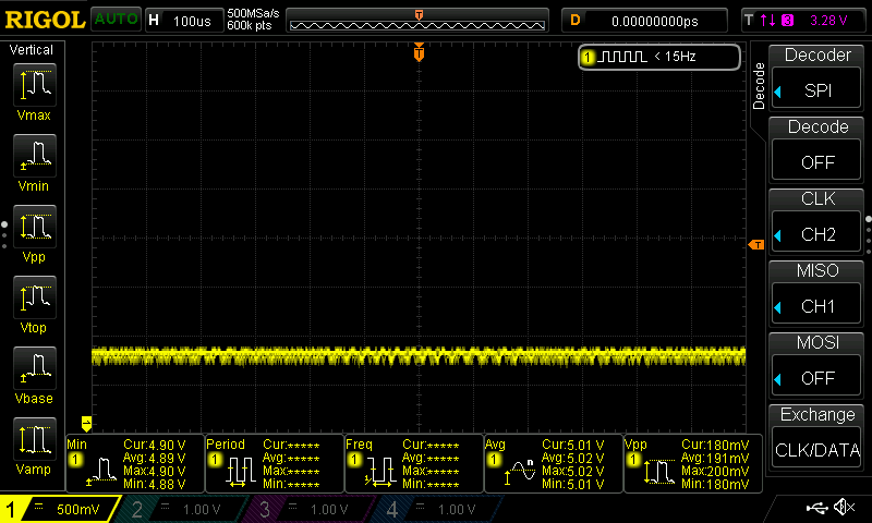

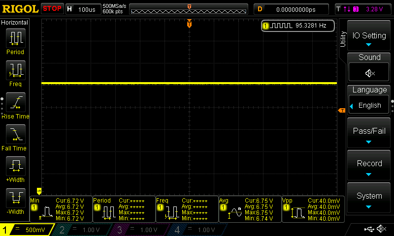

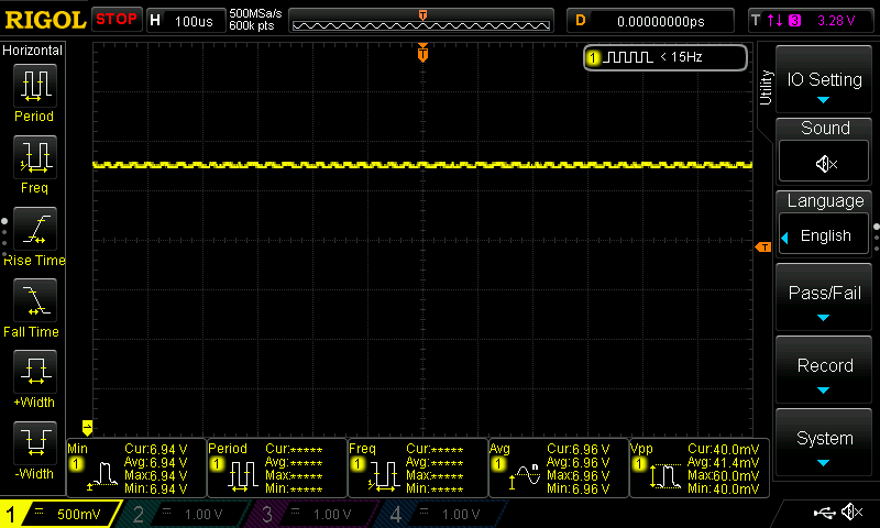

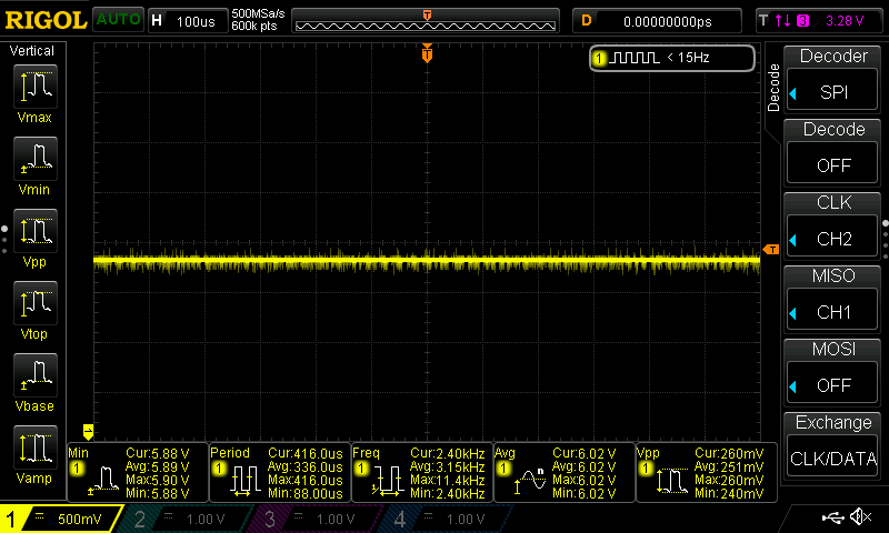

    Thank you for the response. Here are requested measurements. In the bottom i prepared Vpp, Vavg and Vmin. There is a bit of a ripple but shouldn't be a problem in my opinion. What should I check next?
    Vregen:
    Vbus:
    Vsys:
    Vsrn:
