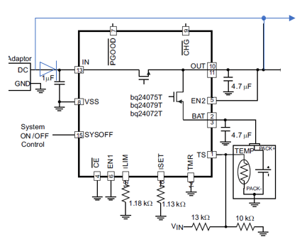

For an application I would like to use the bq24079T as a charger but without the input path (>1.5A load @ 5V).
The bq24079T is used for charging (parallel), discharging and disconnecting the load using SYSOFF.
Would it be allowed to short IN to OUT? Optionally a low drop schottky to IN can be added. IN circuit is: 24Vdc->Diode->Sync buck->5Vdc.
See the picture below:
