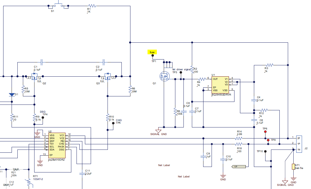

BQ28Z610: How to choose the Fuse such as sluube3 circuit?
Part Number: BQ28Z610

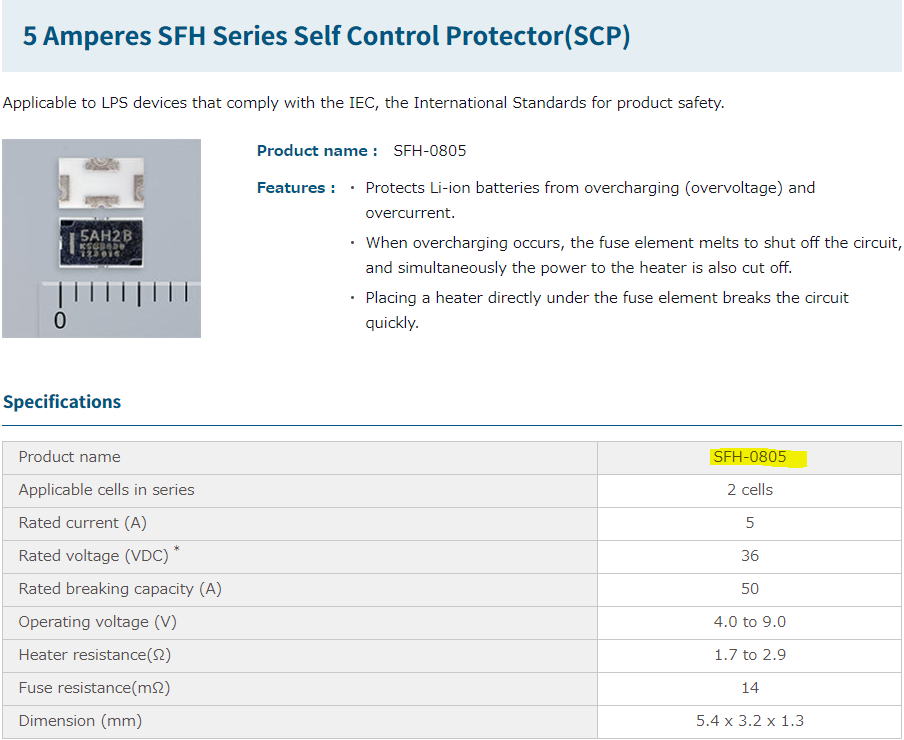

The customer uses the BQ28Z610 as a protection circuit on the charger schematic. And refer to the circuit diagram of sluube3, how to choose fuse (such as the EVM_sluube3 schematic of Figure 1)?
The maximum current is expected to be 4A. Is there a recommendation for Fuse design/type?
<<Figure 1>>

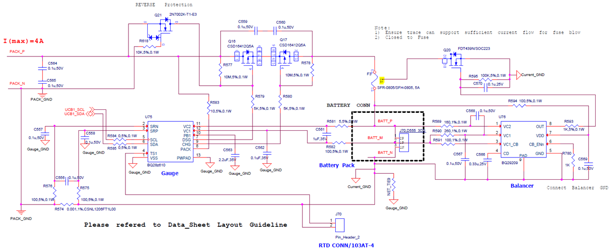

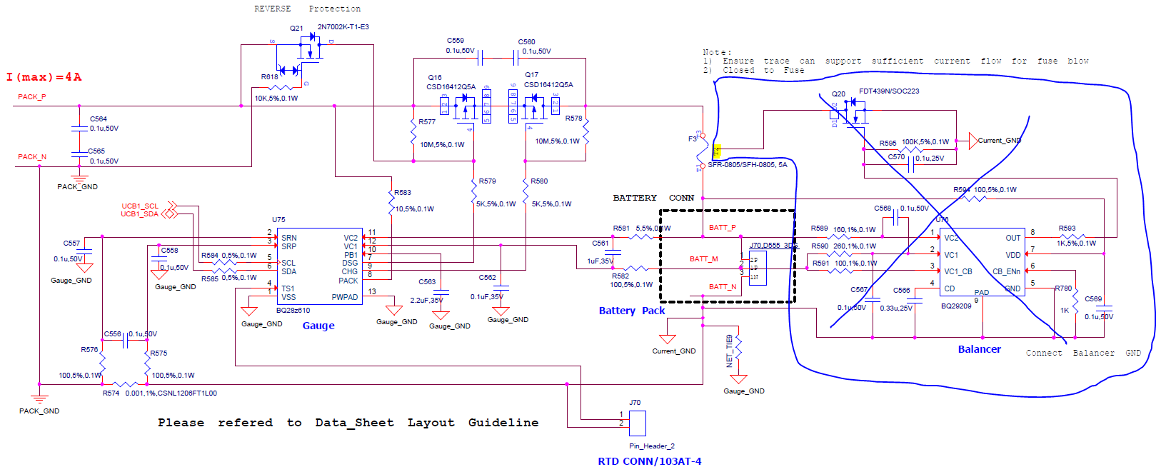

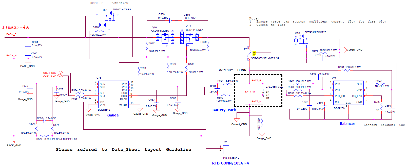

Can you help view the customer schematic such as Figure 2.
Where does “T2” need to be linked?
<<Figure 2>>
