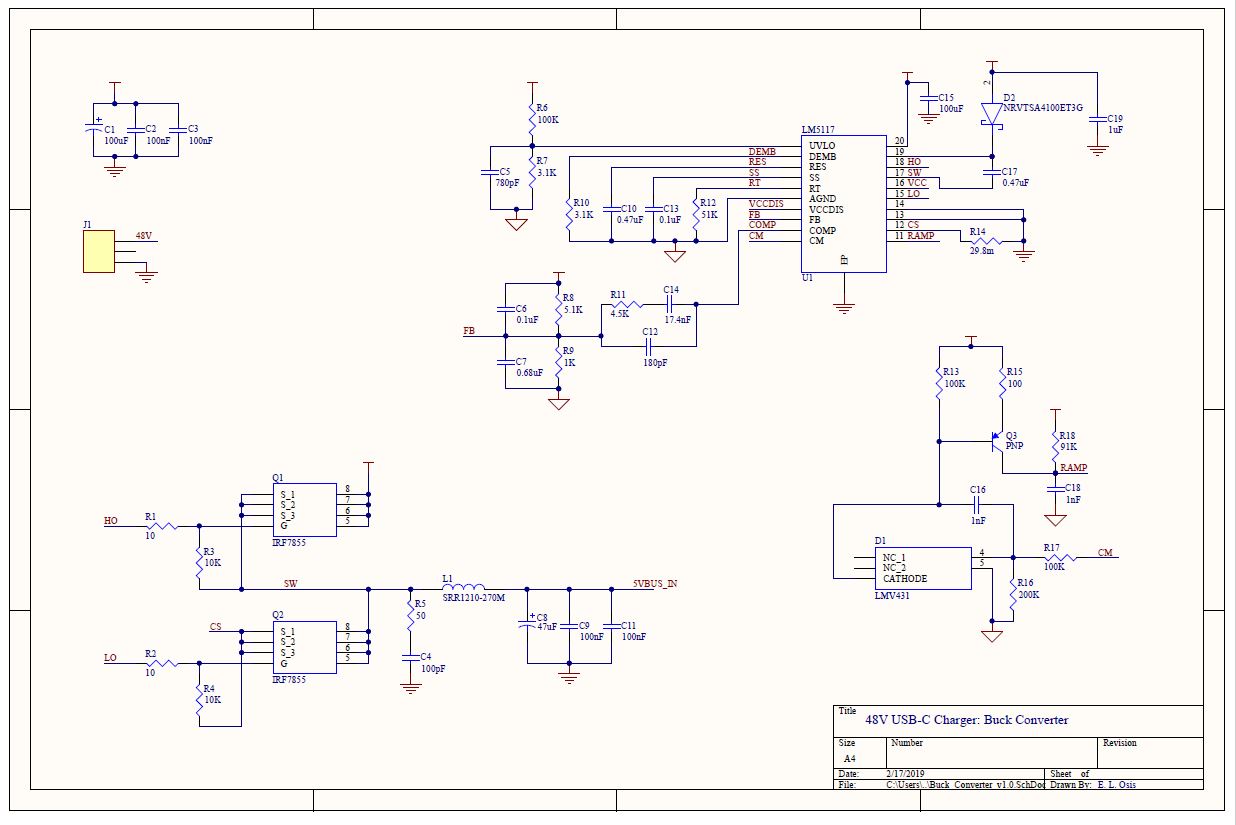

LM5117: VCC pin output is only 5.2V and IC temperature is rising
Part Number: LM5117
Other Parts Discussed in Thread: CSD18563Q5A, TPS25740B
Hi!
I’m developing a 48V to 5V buck converter. I am encountering the following problems:
-LM5117 temperature is too high
-VCC pin output is only at 5.2V
What could be the causes of these problems?
For the lm5117 temperature, I think that the power dissipation is all on it.
