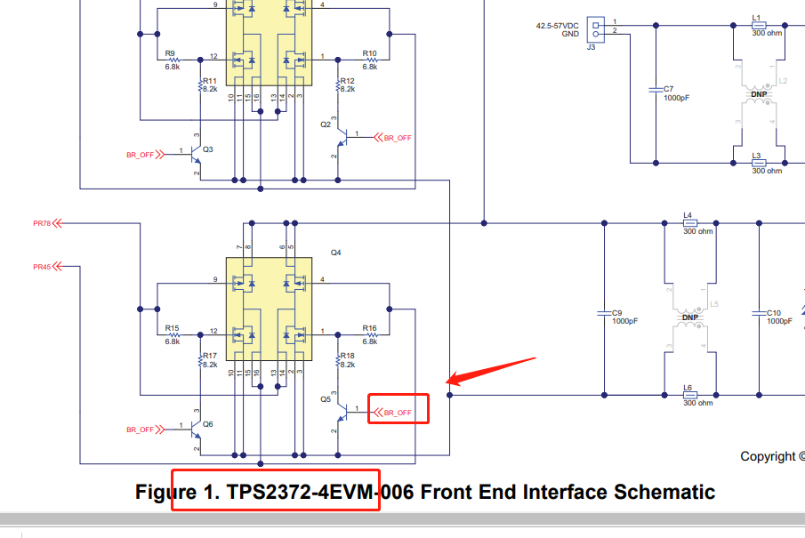

CCS / TPS2372: TPS2372-4EVM BR_OFF Signal problem
Part Number: TPS2372
Dear sir:
Can I remove the BR_OFF signal,Please give me a reply. Thank you.
  • Hi David,
    The BR_OFF signal must be connected to that adapter voltage so that the FET bridge can be turned off to prevent addition current leakage across the pairs so Auto_MPS can minimize power consumption.
    Tom Amlee
    PoE PD Apps Engineer
