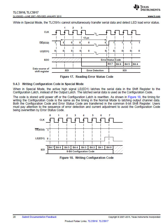

Please let me confirm about correct data sequence, MSB First or LSB First.
When set LSB First, test data was fine.
But I look like MSB First by datasheet page-20(attached), is this misread?
Which is correct MSB or LSB?
