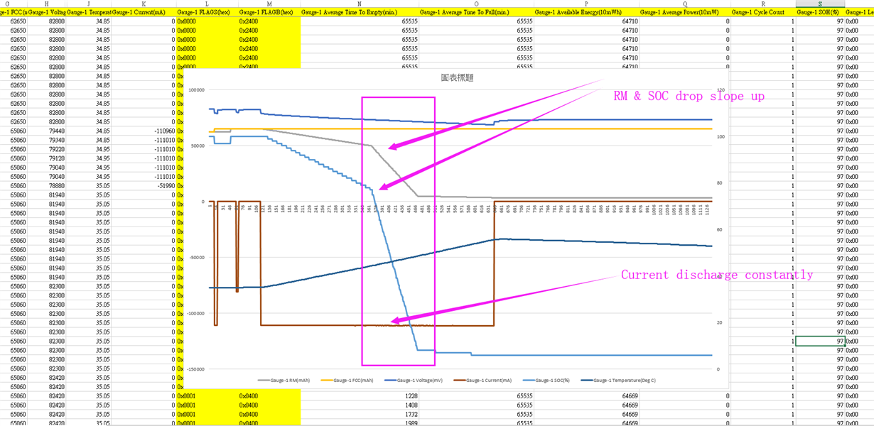

The RM/SOC drop rapidly at around 45 degree C, please help check if have any parameter need to adjust to solve the issue.

Hi Xinxin,
Please ensure that the chemID is a proper fit for the device.
If so, please use the gpcrb to adjust the resistance tables for improved cold temperature performance. More information on how to do this may be found here: www.ti.com/.../sluubd0
The gpcrb tool is found here: http://ti.com/tool/gpcrb
