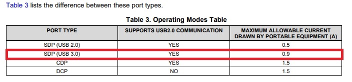

If we connect to SDP (USB3.0) is the BQ25601D capable to detect 900mA current limit?
Because the BC 1.2 on page 44 Table 5-2 says if a PD is attached to a SuperSpeed port, then ICFG max is 900mA.

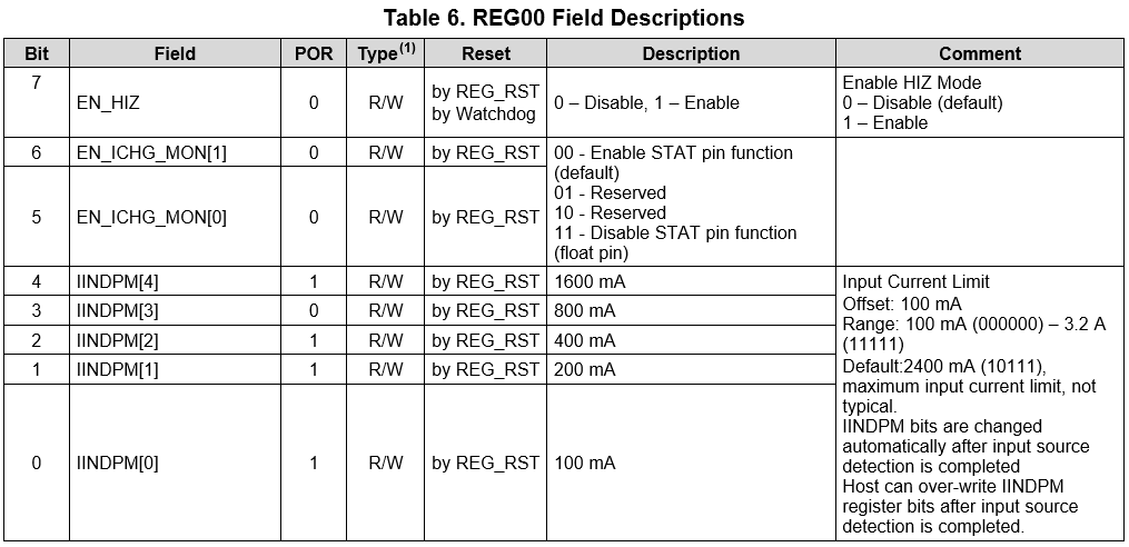

    If either USB 2.0 or USB 3.0 is connected, then the BQ25601D will automatically identify a SDP and set the default current limit to 500 mA. This is the correct value for USB 2.0, but not for USB 3.0. For USB 3.0, the host will need to overwrite the IINDPM bits to 900 mA in register REG00 bits[4:0], as shown in the picture below.
    Angelo
  • Hi Angelo,
    is there a charger controller that can detect USB3.0 900mA through D+ D- , and there is no need for host adjustment intervention?
    David.
  • Hi David,
    No. If our D+/D- chargers detect a SDP, then they default to a 500 mA input current limit. A host or interface will be needed to change this to 900 mA instead.
    Angelo
  • Hi Angelo,
    if no charger ic can't do it,
    are there any usb charging port controllers that can detect the difference between SDP 500mA and SDP 900mA?
    Maybe TPS2549 can tell difference without host ?
    David.

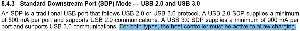

  • Hi David,
    Sorry, I'm not sure because I only support the battery charger ICs. From glancing at the datasheet though, it looks like that device will also require host control:
    Please create a new thread asking about the TPS2549, and the appropriate team within TI will get back to you with a definitive answer and/or suggest another device which might suit your application.
