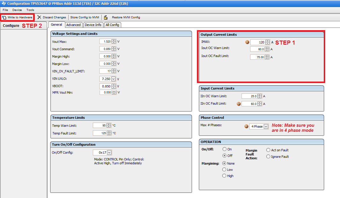

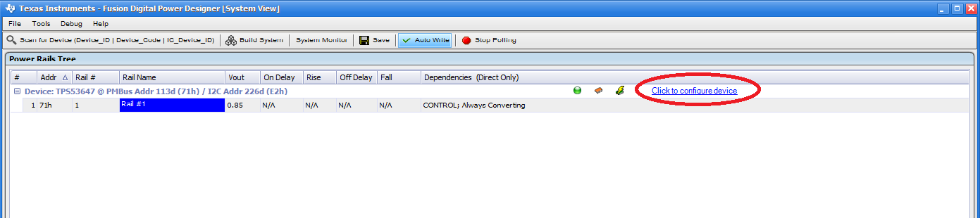

Hi Eli,
You can change several settings of the TPS53647 using the Fusion Digital power Designer (http://www.ti.com/tool/FUSION_DIGITAL_POWER_DESIGNER
and the TI USB-to-GPIO Adapter (http://www.ti.com/tool/USB-TO-GPIO) plugs directly into J4 on the TPS53647EVM-710.
Once you load the program (with the EVM powered up and connected to your computer with the adapter) you will see this window. After clicking to "configure device" the next window you should see will allow to make several changes including increasing IMAX to 120A (Step 1). Double check that you are running all four phases before writing the new settings to the hardware (Step 2). If you want to save these settings so that they stay after the next power cycle, click on "Store Conifg to NVM" on the top.
