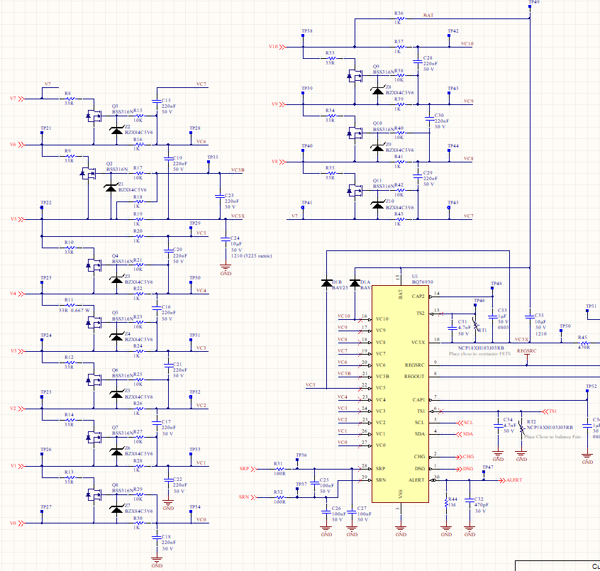

in my design for a 10S battery I have a 10K NTC each in between TS1 & VSS and TS2 & VC5X, both also decoupled with a 4.7nF capacitor.
At room temperature I notice a temperature reading difference of ~3C, but when I cool the NTC's with freezing spray I
see the temperature reading on TS2 drop accordingly but on TS1 it won't go below 14C. My boot circuitry is connected
via a diode and I checked the voltage on the anode side after boot, which is 0V. To be sure of no interference by the
boot circuitry I inserted a switch and disconnected it completely after boot. The reading on TS1 remained unreliable.
Hereafter I replaced the NTC's by fixed 47K resistors but to no avail: TS2 now gives -10C (after conversion) and TS1
14C!
If I measure with a scope (with the 47K's) I see on TS1 a periodic pulse of 50msec wide, 2Vtt every 2 secs, while I see
on TS2 the same signal, but with a Vtt of 2.75V.
The voltage on REGOUT = 3.3V and stable.
Any ideas?

  • Hello WM5295,
    I did what you suggested: I lifted the pin and performed a measurement. Lifting the pin now required a switch in between the pin and the pad as otherwise the device would not boot ;-).
    As a result things got a little bit more obscure for me: after opening the switch, the reading now reports -45C (so a very high resistance -> i.e. as could be expected) and the measurement on the pin showed a 50ms square pulse of 3.3Vtt!!. So the device seems capable of lifting the pin to 3.3V. But..........with a load of 47K (also quite high....) it won't go to the desired level as then it resulted in 14C instead of -10C (2Vtt instead of 2.75Vtt) while with a lesser load of 3K3 the reading was more or less correct (57C), which to my assumption required a higher current into the resistor. I measured the load on the pin and that was what it should be, i.e. I could not measure any other load than the attached NTC.
    It looks to me that for some reason the LDO is limited in its current capability. The voltage on VC5 is 18V and stable, which is for what I could find in the datasheet the supply for the LDO. What could be limiting thie current? Or is there another explanation for the behavior?
    Just to be complete I hereby include the relevant part of the circuitry around the AFE. The Boot Circuitry is attached to TS1 via a diode on another page, but was disconnected via a switch in all relevant measurements.

  • Hello WM5295,
    well......odd is just an understatement until you find the cause....and then odd just becomes plain stupid.
    It had to be something related to the design, as 3 products based on the same design showed the behavior on all assemblies. So it could not be anything with contamination, broken parts, solder joints etc etc etc. And indeed you were in a way correct with your initial assumption that there could be some leakage in the boot circuit. Well...there was...but not directly in the boot circuit. The thing was that the TS1 pin was protected by a 3V3 Zener diode directly on the pin....and although the voltage on TS1 remains way below 3V3 all the time (even during boot), the Zener naturally still draws some current below its Zener voltage. Removing the zener (or better: reconnecting the zener to the anode side of the separating diode) did the trick.
    All in all thus a tempest in a teapot .
