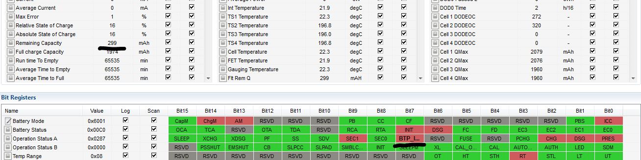

    For BTP, I still have some questions. In your reply, it stated as "either direction", so what this "either direction" means? So the interrupt can be triggered either low capacity and high capacity?
    Back to my question, here is a screenshot from bqStudio.
    1. The remaining capacity is 300mAh, and 150mAh is the threshold. But BTP_INT is triggered. Based on the description from the spec, "OperationStatus()[BTP_INT] is set when:– Current ≤ 0 and RemCap < “set” threshold (“discharge set threshold”= 150mAh)" and the battery did't stay in this range, and BTP_INT should not be set.
    2. I tried to clear this by write BTPDischargeSet(), which will reset the flag as: ”When either BTPDischargeSet() or BTPChargeSet() commands are received,OperationStatus()[BTP_INT] will clear and the pin will be deasserted.”
    However, after it cleared for a little moment (within 2 mins), the flag would be set again. The battery still have 299mAh left.

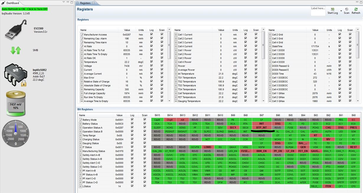

    3. The BTP threshold is set as below:
    So theoretically the BTP_INT should be set if RemCap <150mAh, and recover if RemCap>175mAh?

  • Either direction refers to either charge or discharge. BTP asserts either way whenever any threshold is crossed, it is direction independent. It's up to the host to control the BTP writes to reset the flag in the register.
    First, let's say you are at 300mAh, now program both your thresholds to any value below, set = 150, clear = 175. Then reset the gauge. Now your BTP flag will remain cleared
    Then on dsg, if you cross below 150mAh with a dsg I, then BTP gets set (using set threshold). Now, you can choose to write a different lower threshold to reset it (say 100mAh). Once it crosses the newer threshold it will set again. If not, it will remain cleared.
    Now, when you start charge then BTP gets set when remcap exceeds the clear threshold with a chg I. Again you can reset it with a higher threshold written (say 200mAh) at which point the interrupt and register will set again.
    The whole point of this exercise is for the host to have some arbitrary value at which it wants to trigger an interrupt in either direction.

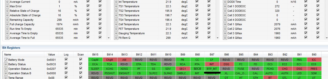

    1. During DSG or idle, the battery should not trigger BTP_INT: RemCap 300mAh, set =150. However, the flag was set, and after manually cleared, it was automatically set again, as shown below:
    BTP_INT cleared manually:
    Reset automatically after about 1 minute, the battery was idle, without any CHG or DSG:
    Do you have any experience on this? Any settings were wrong?

  • I can't see how it set without a log. We want to trigger BTP during charging as it might be a state wherein you would like the charger to boost the charging rate or for any other reason.
    No, you will trigger a BTP pulse if you are charging and remcap is > clear threshold. Set will influence BTP on the way down while clear triggers it on the way up in chg.
