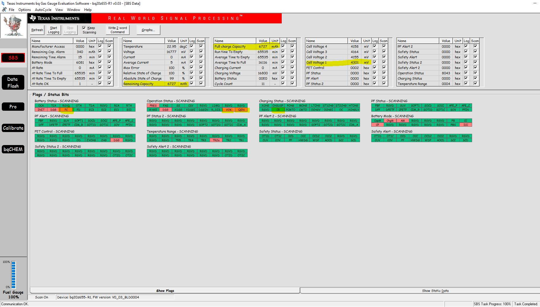

BQ20Z655-R1: Some Problems about Creating Data Flash Parameters
Part Number: BQ20Z655-R1
 I am trying to configure data flash parameters for my 4s battery pack but I have some questions. Could you help me about that? You can see my data flash parameters on this link:

  1. For termination:
Could you please check the following data?(Note that 100mA charging cut-off current)
    1. Taper Current=100mA
    2. Discharge Current Threshold= 90mA
    3. Charge Current Threshold=90mA
    4. Quit Current= 10mA
  1. CONTROL for Cell Balancing:
How can I check the cell balancing function if it works? I would like to be sure and I would like check this function. Can I use [CB]flag for that?
  1. For gg Files:
Could you please check my gg files(2s and 4s configuration)? As you can see, update status is 0x0E and min cell deviation is 1350 for 2serial configuration. But cell balancing function is not working( CB flag = Low). How can I solve this problem? I know that I have to do learning cycle for my data that’s why I will do it. But now I would like to do test for cell balancing function as soon as possible. Therefore I’m using gg file that have a update status=0x0E. Do you have any example gg file for testing? If it possible could you please provide me example data with internal or external cell balancing function. If not, could you fix my data?
  1. For Balancing:
Reference for min cell deviation value: http://www.ti.com/lit/an/slua420a/slua420a.pdf  .
Could you please check my values?
  1. Internal Balancing: For 4 serial configuration with internal cell balancing, cell filter resistors are 100 ohm that’s why min cell deviation value is 1350 s/mAh
  2. External Balancing: For 4 serial configuration with external cell balancing, cell filter resistors are 1k ohm and balancing resistors are 50ohm that’s why min cell deviation value is 130 s/mAh. I’m calculating as below:
R= 50 ohm + Rswithingmosfet = approximately 52 ohm
DF:MinCellDeviation = R × 3.6/(V × D) = 52 x 3,6/(3,6 x 0,4) = 130 s/mAh
