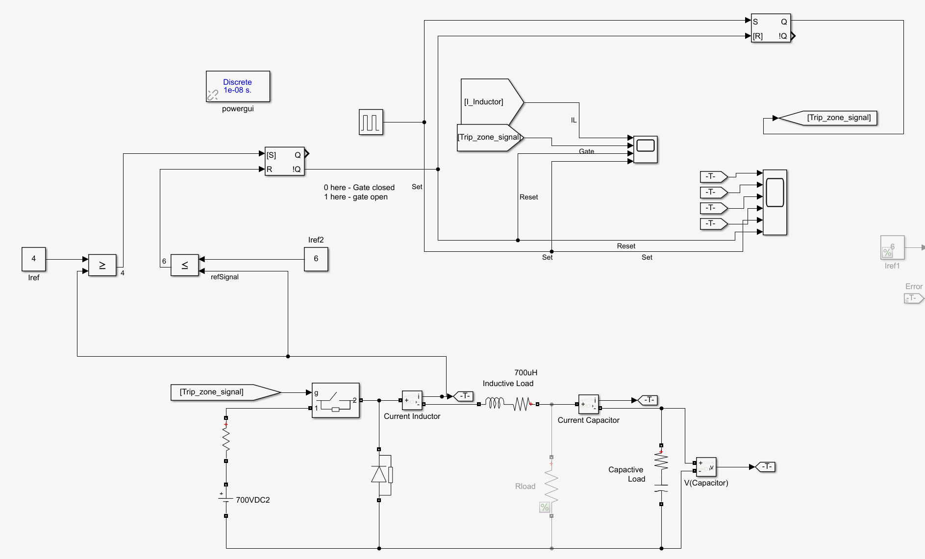

    I decided to use the C2000 with trip zone.

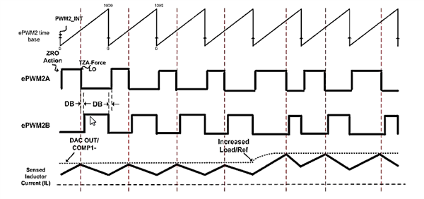

    When the ePWM2 time is equal to 1e-6 (1MHz)
    How could I know what the maximum frequency of ePWM2A is while doing peak current mode, I need to know this for determine cooling for the MOSFET..
    Also if I want an maximum ripple of 2A which means the inductor current should stay between 4A and 6A.
    Should I only make a tripzone for the 6A or also for the 4A?

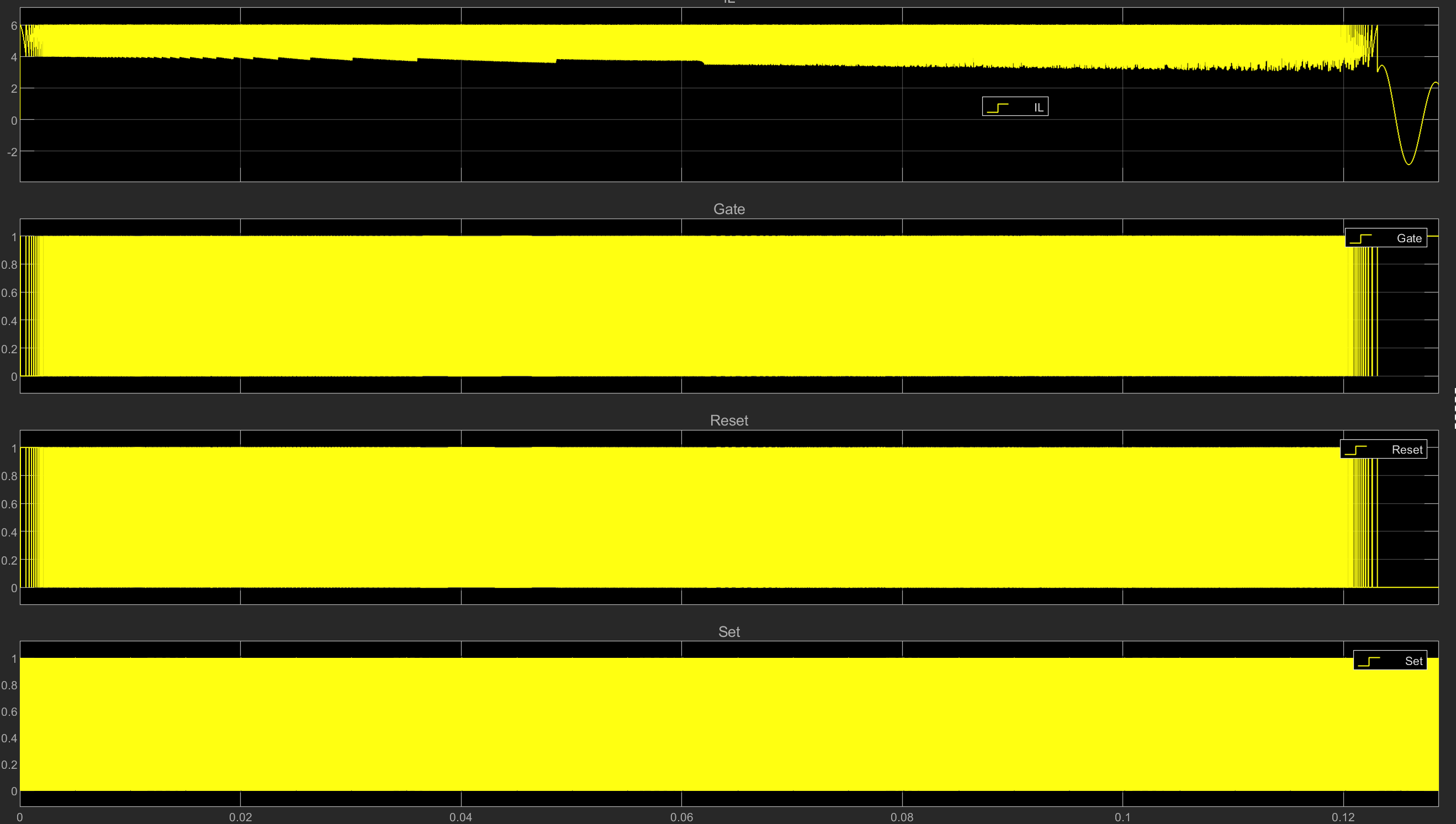

    Right now I tried to make the tripzone only for the 6A in simulink but during the charge proces

    1. You can find the HRPWM frequency information in the datasheet and TRM of your device.
    2. It depends on your requirements. If you need another 4A threashold, then you probably can use the other channel of the CMPSS module and get the signal back to the tripzone of PWM module.
    Chen
