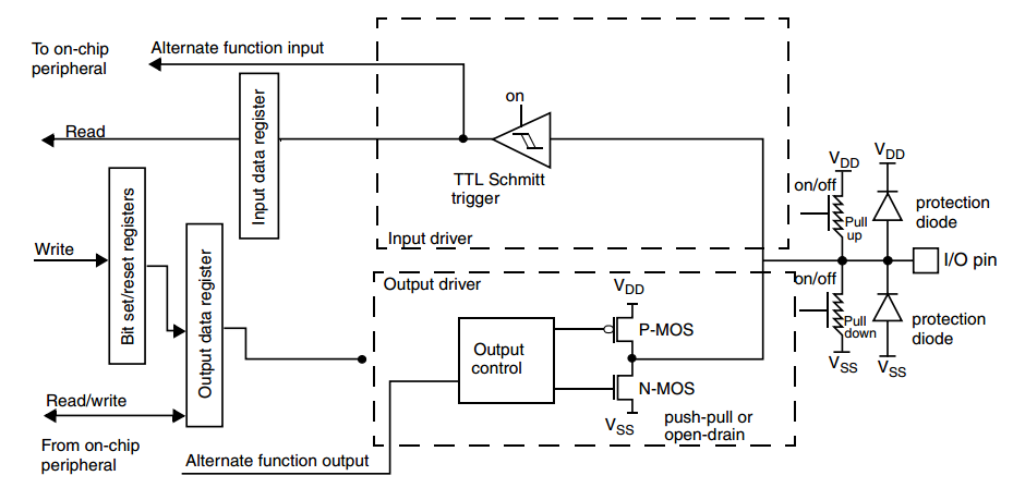

What is the architecture diagram of GPIO on UCD3138064 ?
Is it same as blow diagram ? Could you provide the diagram in UCD3138064 ? thanks a lot.
