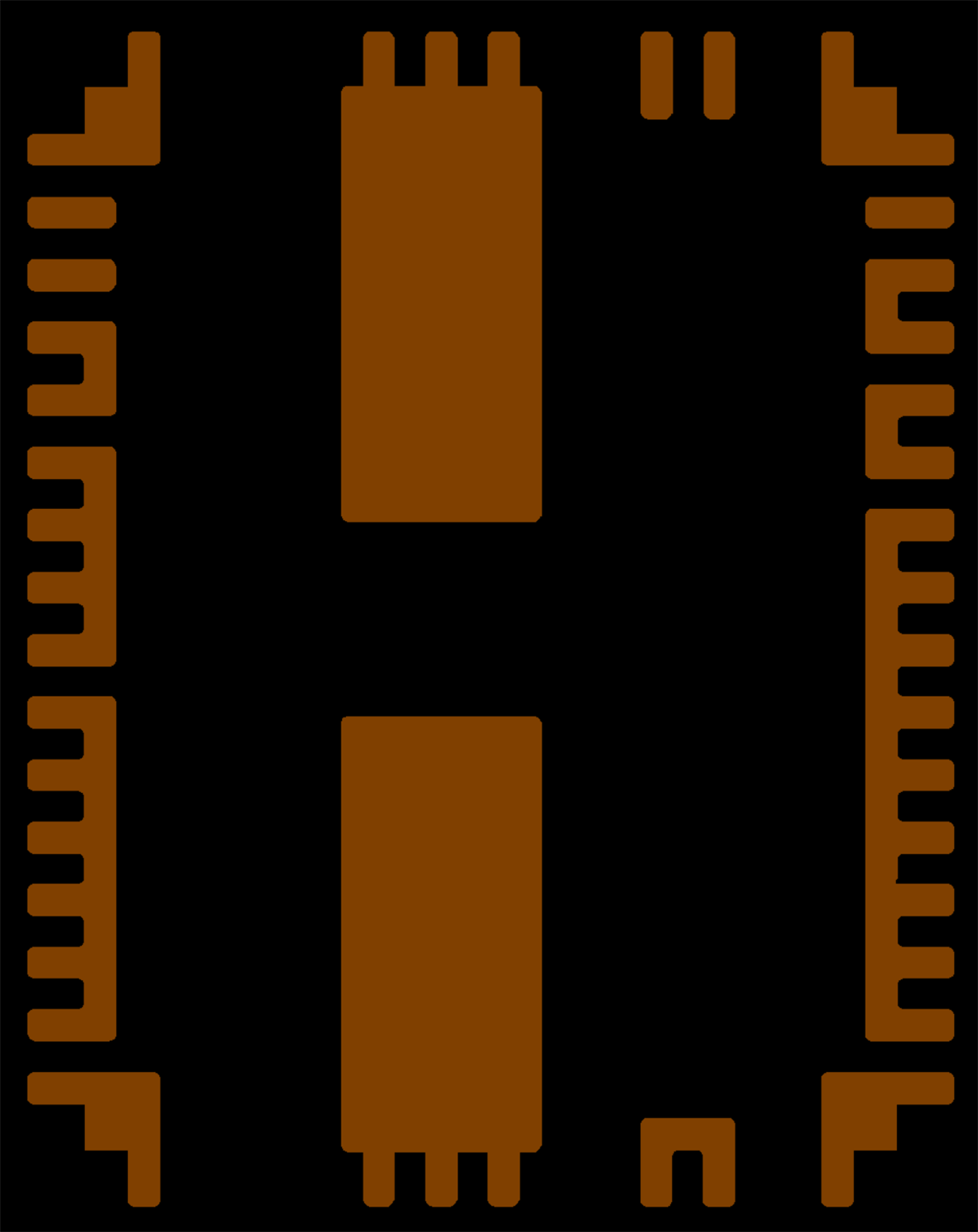

Having extreme difficulty getting a RLR0018A footprint into PADS VX2.4. In addition to corrupt Ultra Librarian stencil and soldermask layer shapes, I get a nastygram about the multiple vias, "Duplicate of Pin number 'V'".
Any ideas?
Any ideas?

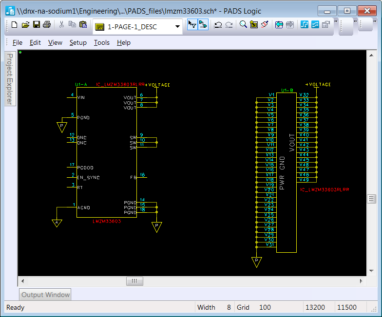

In order to include thermal vias in a PCB footprint decal, PADS requires each of them to have a pin number and be connected to a net along with the copper shape that contains them, in order to pass spacing and connectivity checks. I was able to duplicate the footprint's soldermask and stencil art from the Eval board Gerber data, but I'm still struggling with how to properly set up the post-processing to get the desired stencil Gerber data out of a layout...
Corresponding schematic:
