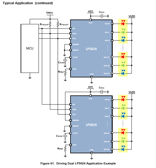

Hello
1. what's the LDO output voltage Vcap ? is 1.8V ?
2. I using 2 pcs LP5024 like Figure 61, but I will connect all Vcc, Vled, VMCU together to 3.3V,  do you think its ok ?
  • Hi, Fandy,
    It's 1.8V.
    For 3.3V Vled, what's your LED forward voltage Vf and current per channel?
    You need to make sure the voltage drop on the OUT 3.3V - Vf is enough for constant current. Please refer to Figure 7 in datasheet.
