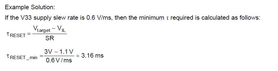

After I read the latest layout guide,I have 2 questions to ask in Chapter 4.
1. I know the slew rate of V33 is 2.6V/ms~6V/ms.However,why the V33 supply slew rate is 0.6 V/ms in RC Time Constant?Is that not contradictory?
2. Some parameters I can't find in datasheet.I want to know the value of Vtarget & VPOR .
