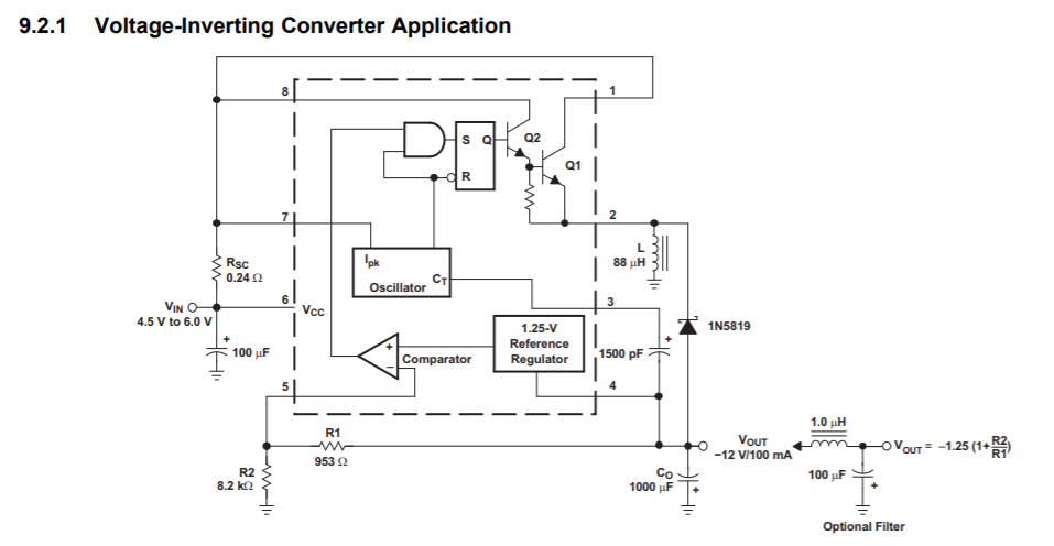

Hi team,
I want to configure MC33063 as shown below.
The following are the spec:
VIN=6.4V, VOUT=-6.4V, Iout=100mA, output voltage ripple<30mV.
Could you please help suggest the inductor value and circuit parameters? Whether I can choose smaller inductor?
Thanks a lot for your help!
