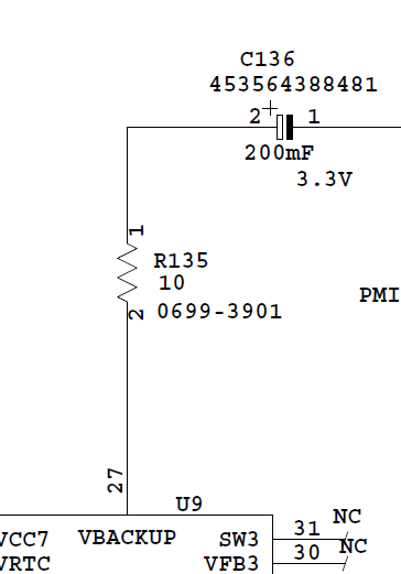

hi, dear
      In my design, the PMIC RTC is used for a back-up RTC , when the AC/BATTERY is not present. we use a super-capacitor (3.3V 200mF) to supply the RTC power, series a 10 ohm resistor for current limit.
refer to the datasheet, when AC/BATTERY is not present, VBACKUP is the only power supply. as shown in the datasheet, the power consumption is 6-9uA.
according to the condition, would you please help to calculate how much time will the RTC of PMIC be maintained?
thanks
    Looking at the datasheet, it looks like VRTC will continue to operate until VBACKUP < VBNPR (Figure 5-3) which has a max value of 2.2 V. If discharging a capacitor with a max 9 uA from 3.3 V to 2.2 V, and delta V = I*t/C, then I calculate a worst case time of 6.8 hours.
