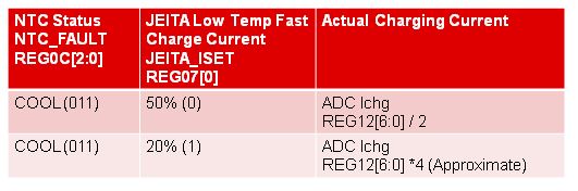

   When we set the charge current from 2A to 500mA when the temperature decrease to 13℃. We can measure the current to be 2A by multimeter, and we also can read the register from MCU that the current is 2A. But we the TMP decrease 13℃, the charge current is 500mA from the multimeter, but we read the register that the current is only 100mA. We thinks the ADC has some problem ? Can you give some suggestion aabout this?
    At cool temperature (T1–T2) REG0C[2:0]=011, ADC Ichg reading is not accurate. Please use the table below to configure the actual charging current.
