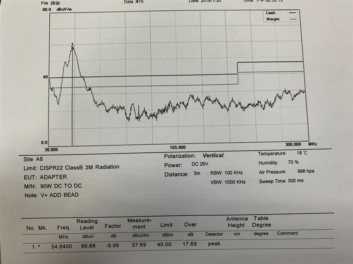

My customer test LM5176 EMI radiation,over 80db at 40~80MHz,Please provide solution,thanks.
Test report, circuit and layout as follw:

My customer changed the gate resistance to 0 ohms, but the IC, MOSFET and Fuse both died when the load was turned on.
Does the LM5176 have similar similar files for reference?

Hi Hsu,
The LM5176 has a series of blogs that covers layout tips. These should help with the layout of the circuit.
The AC loop is between the MOSFETs and input capacitor (buck leg) and the MOSFETs and the output capacitors (boost leg). These are the loops that should be minimized.
