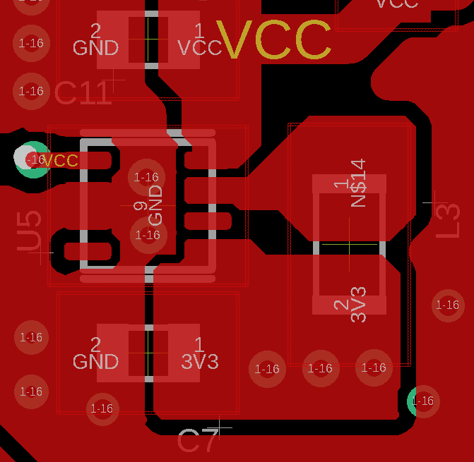

We recently started using the fixed 3.3V version of the TPS62082 (TPS62082DSG) switching regulator and are finding that the output is off by about 60 - 50 mV (3.24V instead of expected 3.3V).
We suspect that it's due to our inductor choice having a larger DC resistance, but are not completely sure.
Attached is a snapshot of our circuit and layout and listed below are the PN for the passives:
C11: GRM188R61C106KAALD
L3: DFE201210U-1R0M=P2 (95 mOhms max DC Resistance)
C7: GRM188R60J226MEA0D
Could we receive some assistance in optimizing our output to achieve 3.3V? This is a time sensitive issue and any help would be greatly appreciated.

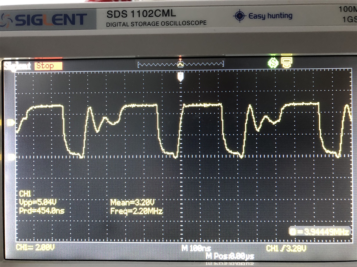

    Vsw: (measured at pin 7 SW) - see oscilloscope photo figure 1
    Figure 1 - Vsw
    The waveform doesn't look good, and it seems that your device is in discontinuous mode. So, can you tell me how and what is connected to the input and output of your device? Which current is required by your load?

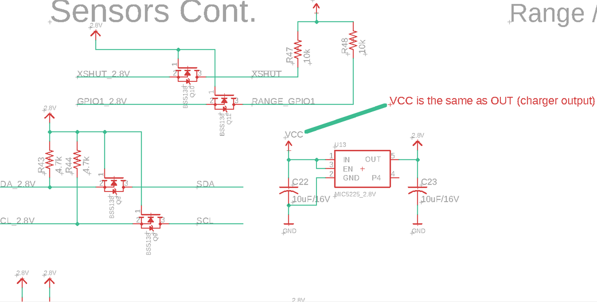

    1. We are seeing this 3.24V result with (see schematic snapshot that shows the charger with USB / Battery input):
       - a single cell LiPo connected to a TI charger IC
       - with a 5V USB charger supply
       - with both Battery and USB charging
    The picture below shows the TI charger with Battery and USB (5V) input. The 'OUT' signal from the charger is the Switcher 'Vin'

    Yes, the charger 5V output is connected to several other components:
    1. two LEDs
    2. a 2.8V regulator

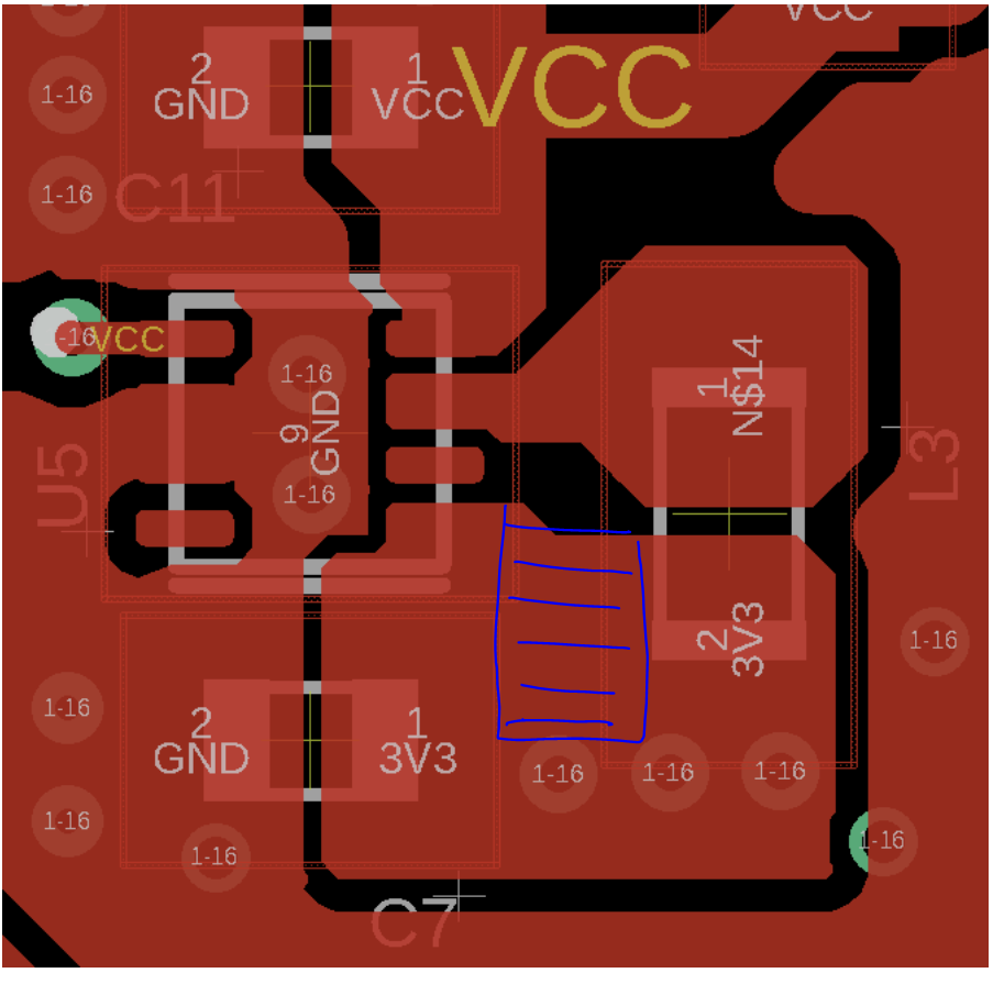

    I rechecked your layout, trying to understand what is the root cause of your problem. I attach a picture with a suggested cut of the trace close the Vos pin; this is a signal pin that is very sensitive to the noise. Regarding the accuracy is specified only for 0A (load). I am going to close this post, but you can reach me on my email a-furio@ti.com, to support you when you will have the result of this layout's modification.
  • Great, thank you Alfonso. We will try you're suggestion.
