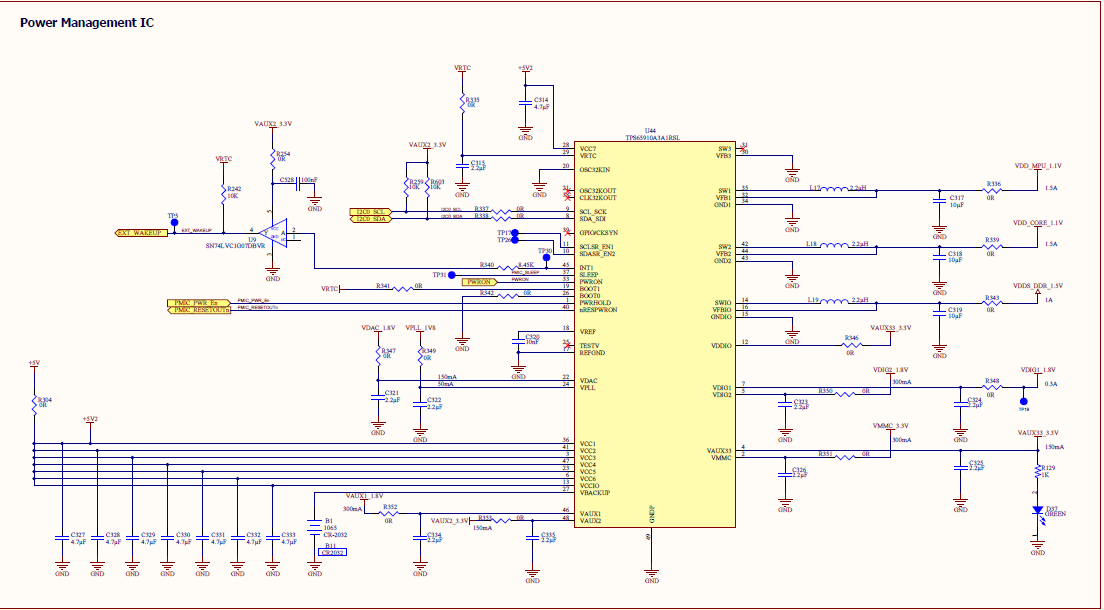

We have a custom board based on am3352, powered by tps65910 PMIC which gets power from an external adapter (24v,5A), PMIC is going to RTC only mode on giving "poweroff" command, but want to know whether it goes to RTC only mode on power cut, below is the snapshot of the power supply from PMIC, linux kernel version 3.14.
    It's the AM335x that goes to RTC-only mode, not the PMIC. When the input power supply to the PMIC is off the entire system will have no power supply.

    Thank you for your quick reply, yes its AM335x which goes to RTC only mode by making "PMIC_PWR_En" pin off PMIC low on giving "poweroff" command, but when the power goes off, i probed "PMIC_PWR_En" pin it was still high, so my doubt is whether it dissipates more power during this time, since the battery is draining fast. And is there any means to make it low during power cut.

    Thank you for your valuable inputs, on giving "poweroff" command AM335x goes to RTC only mode everything works as expected, but the only problem is we are using an adapter (24v,5A) to power up our board, on turning it off without running "poweroff" command the " PMIC_PWR_EN" pin still stays high, is there any ways to make it low.
