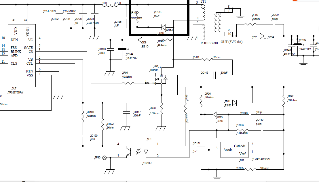

We use TPS23753 to design power module reference TPS23753AEVM.
When the feedback is abnormal, eg.(optocoupler Open circuit which connect to "CTL" pin ), TPS23753 is damaged.
Is there any solution to avoid the damage even if feedback is abnormal? Thanks!

    If the optocoupler is open circuited, the pull up resistor, RCTL (from our flyback design guide slva305c), should pull it to VB which is below the abs max for CTL.
    Could you provide more details about your design, schematic, & your test conditions? Are you doing any testing that requires you to open circuit the optocoupler?

    Thanks! Schematic as below. There is a  pull up resistor (2R102) between CTL and VB.
    Because of the limited welding level, sometimes optocoupler is faulty welded (or omitted)。Then there is no feedback for IC, IC will be damaged.
    So we should solve the problem: IC should not be damaged even if feeback circuit is fault.
    Thanks!

    Is there any more comments for current issue? How to add protection circuit to avoid Chip damaged even if feedback is abnormal.
  • Hi Cary,
    If exceeding max voltage is a concern, then you can add a Zener (>5V) to the CTL pin, however be mindful that this will introduce parallel capacitance that may change your response. If you are experiencing ESD events that may be damaging the device, then using TPS23753A is the way to go.
