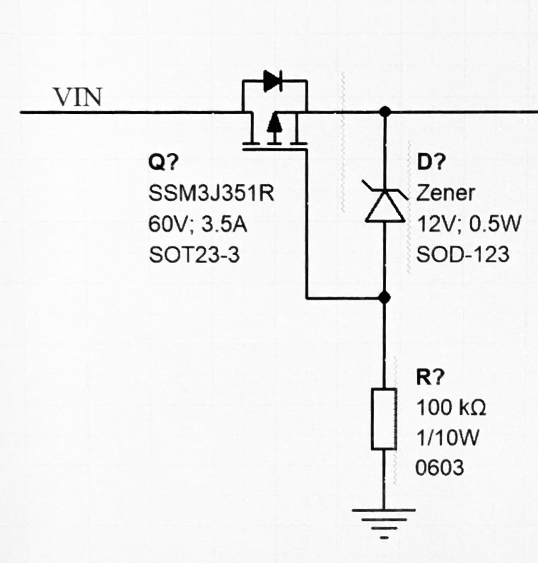

Dear Team,
  I m using reverse protection mosfet circuit as described in the image that attached below for TPS54302 and output voltage is set to 5V.
  Tested with 0 to 30V  5A adjustable power supply as input and works without a problem. (Also works without a problem with a 12V 7Ah SLA battery.)
  But when i connected a  24V 7Ah SLA battery (output voltage was 25V) to the circuit, both mosfet and TPS54302 were burnt out.
  Is there something that i miss all along?
