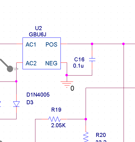

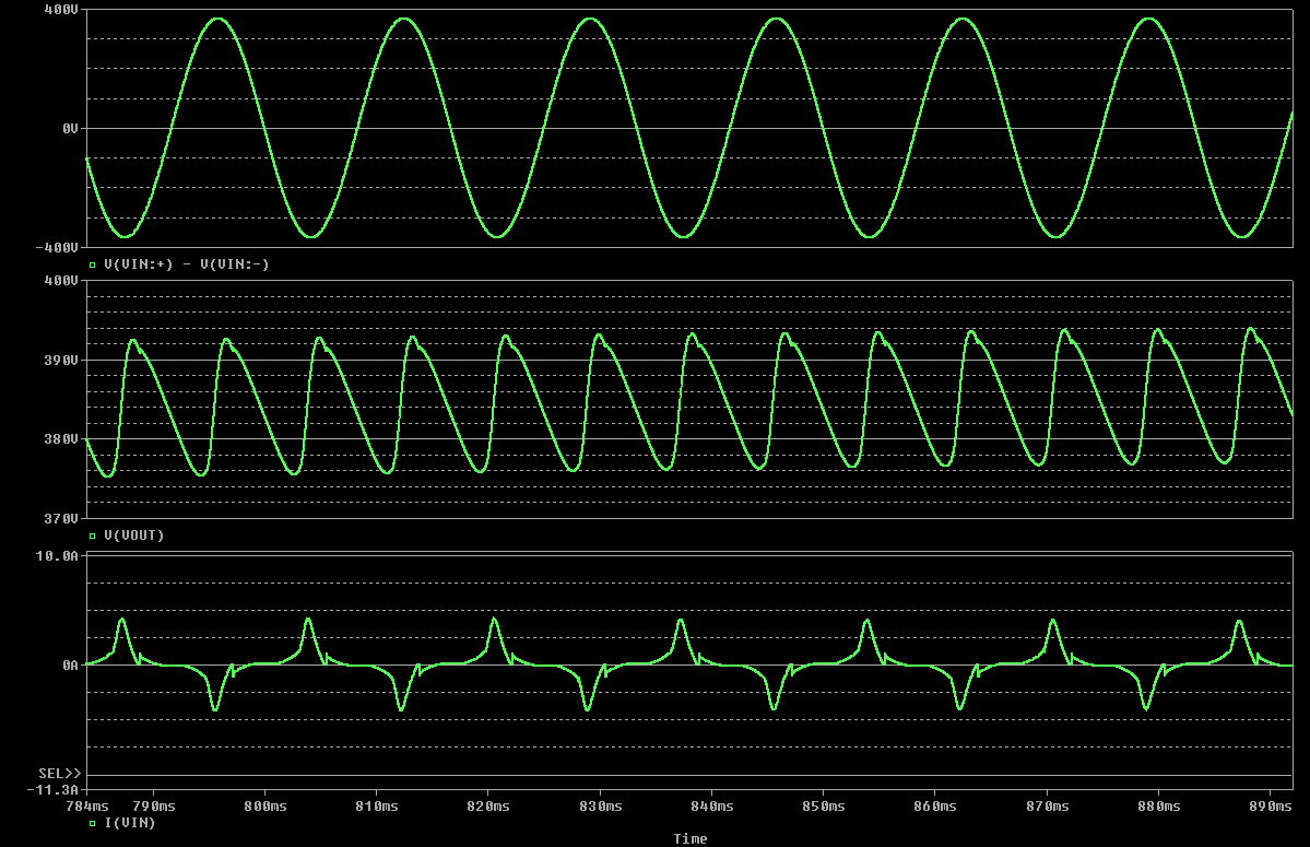

    The input current in Pspice model is plotted below.
    Do you expect a sinusoidal nature here?
    I looked into the model and it seems the above current nature is due to GBU6J. This model is drawing this current from input source. I am debugging this and get back you with reason for above behavior.

  • Hi Saket,
    Here's the feedback from customer:
    Customer>>>Yes of course. PFC cannot achieve power factor 0.99 without having the current synchronized with the voltage. THD measurement will be high if that’s the current waveform.
    You should also see some switching currents riding on the AC currents but should be small. The waveform looks like the PFC controller is not switching. Only the bridge rectifier function here.
  • Hi Eddie,
    The UCC28070 transient model is derived from UCC28070 average model. We will not observe any switching waveform here and voltage and current at nodes are respective averaged values.
    As per my understanding, the current shaping circuit is not modeled and that is the reason we do not see any sinusoidal shape of input current and as you pointed out model is not actually replicating PFC operation.
    So, as this is an average model based transient design we will not able to use it for interleaving, sync or similar features.
