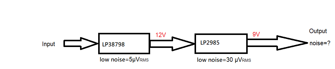

     I have some question in low noise application.
     I want to use LP38798 drop volt to 12V, and use LP2985 drop 9V to OPA use.
     I see datasheet define LP38798's noise is 5uV, LP2985's noise=30uV.
     What is the noise output?
      Is the noise LP38798 5uV or LP2985 30uV?
thanks.

    For linear regulators, the output noise is the self generated noise which comes primarily form the internal reference. PSRR is a measure of the regulators ability to filter the input rail. Since the ultimate goal is a "clean" output rail, you will want a regulator with a high PSRR metric and a low noise metric.
    In your application the LP38798 noise will be filtered by the PSRR of the LP2985; however, you will still see the self generated noise from the LP2985 on the output.
