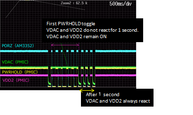

Hi, team.
We are developing a system using AM3352 and TPS65910.
PWRHOLD is controlled from the outside and turned ON / OFF.
LDO and DCDC do not turn off for 1 second from the first PWRHOLD toggle. Why is that?
Are there any restrictions on the input timing of PWRHOLD?

  • Hi Brian-san,
    Thank you for your reply.
    Look at the waveform that was attached in the first post. After the 984 msec timer has expired, the device can be turned off. If the device is turned on again within several hundreds of milliseconds, it can be turned off within 100 msec, so that it looks like the 984 msec timer has still expired. Then, if the device is turned off after being kept active for several tens of seconds, the 984 msec timer works again.
    Why is the device turned off before the 984 msec has passed after the device is turned on?
    Daisuke

  • Hi Brian-san,
    Thank you for your reply. Sorry for my late reply.
    This behavior is observed on our customer's board. The customer probably uses a 3rd-party OS, and DEV_SLP may be set by the OS. However, the waveform (yellow trace) that was attached in the first post shows, the device is turned off by the PWRHOLD signal being low every time. So that, the device should transition to the OFF state instead of the SLEEP state.
    Can the device transition to the SLEEP state by the PWRHOLD signal being low?
    Is there any other reason why the device turned off before the 984 msec has passed after the device is turned on?
    Daisuke

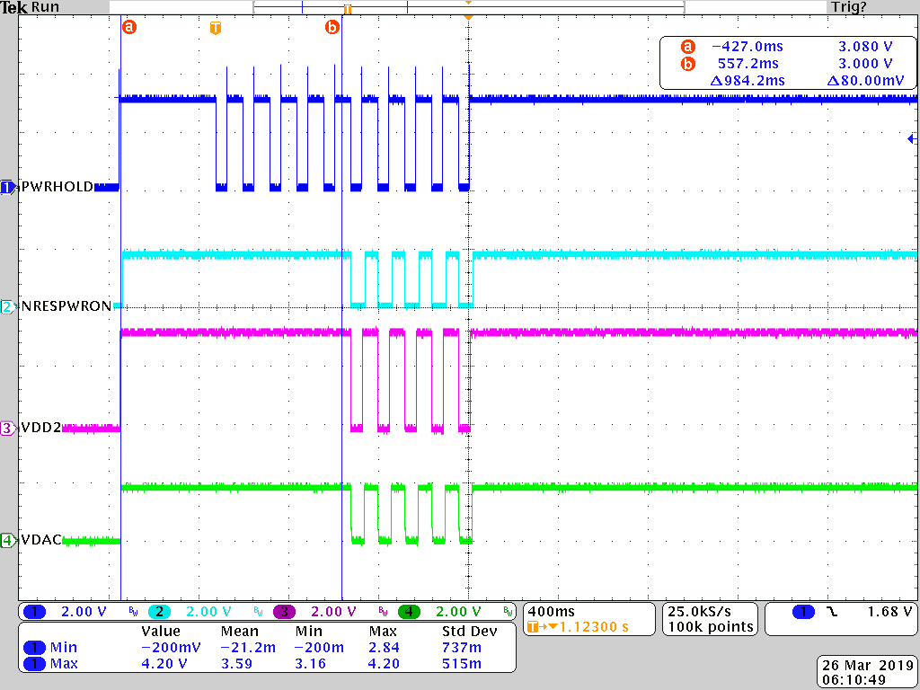

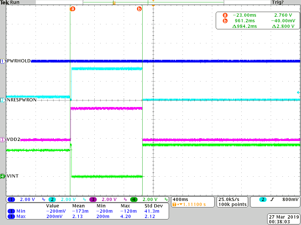

  • Daisuke-san,
    As you can see, I get same results as your original test in the lab. For approximately 984ms after NRESPWRON is set high, a change in the state of PWRHOLD is ignored. After approximately 984ms, any time PWRHOLD toggles from high to low, the TPS65910 will transition from the ACTIVE to the OFF state immediately.
    This scope shot, taken from a different perspective (nINT1 on Channel 4), also confirms my original reply to your question: The PWRHOLD pin is ignored for 984ms because the tdONPWHOLD timer has not expired. This scope shot matches the timing of tdONPWHOLD, as shown on Figure 5-4. PWRON Turn-On/Turn-Off on page 40 of the TPS65910 datasheet.
    As soon as the tdONPWHOLD timer ends (approximately 984ms), any toggle on PWRHOLD will transition the device to the OFF state. PWRHOLD is only a condition for transitioning from ACTIVE to OFF.
    The DEV_SLP bit is a condition for transitioning to the SLEEP state, but as you can see in my setup the DEV_SLP bit == 0b
    Therefore, the PMIC has never transitioned to the SLEEP state, and in both of our tests the PWRHOLD pin going low sends the device into the OFF state after the tdONPWHOLD timer ends.
  • Hi Brian-san,
    All issues are not clear. It is observed on our customer's board that the tdONPWHOLD timer works again when the device is turned off after the device is kept active for several tens of seconds.
    What are the conditions for the tdONPWHOLD timer to work again?
    What is the time defined for the tdONPWHOLD timer to work again after the timer ends?
    Daisuke

  • Hi Brian-san,
    The TPS65910x Schematic Checklist (Rev. B) describes that the PWRON pin can be floated if it is never used.
    Could you tell me about the conditions for the tdONPWHOLD timer to work again?
    The tdONPWHOLD timer seems to stop working once it ends because VDAC and VDD2 turn on and off every time PWRHOLD is toggled. After the device has been kept active for a while, the tdONPWHOLD timer seems to work again because VDAC and VDD2 keep on when PWRHOLD goes low.
    Daisuke
