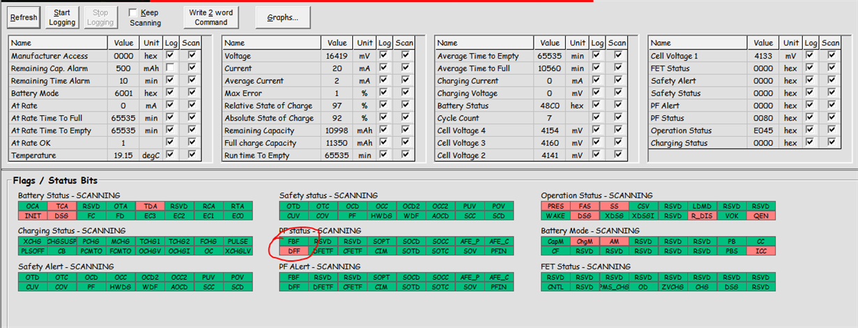

BQ20Z95: BQ20Z95 occurs DFF
Part Number: BQ20Z95
Dear colleague,
Our customer is using BQ20Z95, after a period of normal operation. Pack can't be charged or discharged.
They review the data as below:
When they write the configuration file from the problematic board to a normal board, the normal board can't work right.
I think the reason may be the MCU do the wrong operation in Data Flash reading or writing process.
So do you have some suggestions?
B.R
Rock Su
  • You have DFF set. That means the device has a dataflash failure. You can try to recover it by going to ROM mode and reprogramming it after clearing the PF. If it fails again, you have a bad part.
  • Thanks a lot!
    But how to avoid this problem? Below is the configuration file that happened error.

  • You can't prevent a dff. It means that the IC has a flash memory problem and therefore flash writes have been disabled. It can happen for one of three reasons listed here, bad flash checksum after reset, data flash write not verified, data flash erase not verified. You can try reflashing your fw and seeing if the PF goes away but most likely you have a bad IC.
