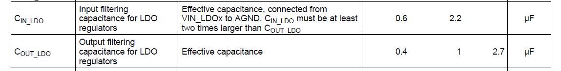

  • How can we guarantee stability by given capacitor? According datasheet maximum of 2.7uF is specified

    We have had customers use larger capacitances than the 2.7uF that is in the datasheet without issue. The only thing to watch out for is the inrush current causing the LDO to hit current limit. This can be calculated using C = I / (dv/dt)

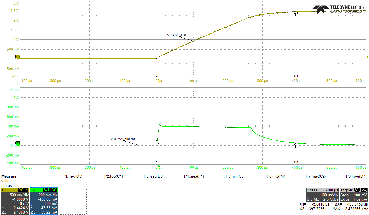

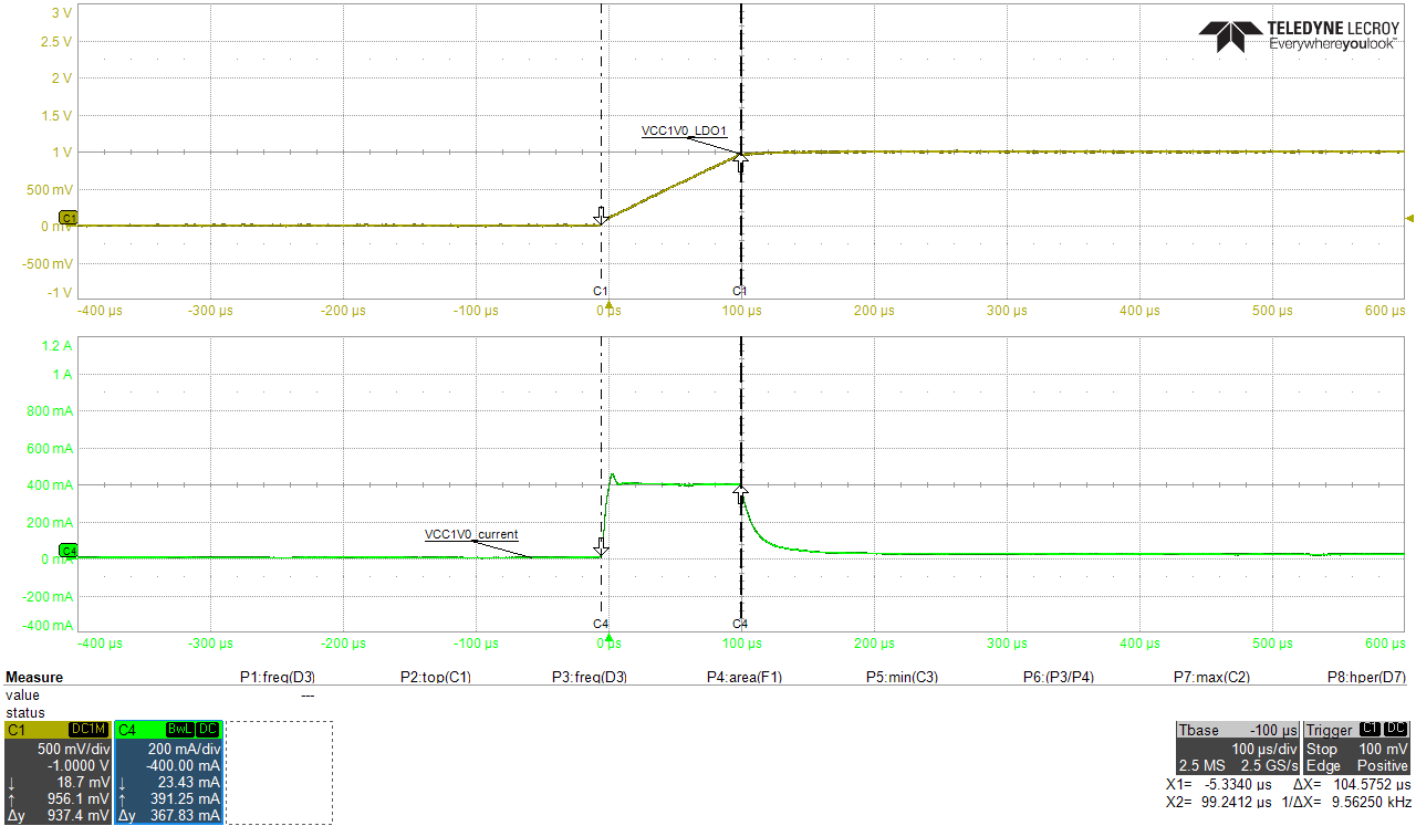

    Regarding the worst case capacitance the application is using 66µF  with tolance (+10%) and over temperature (+3% at -40°C)
    Our startup measurements shows the current limit of 400mA is triggered during initial ramp up.
    LDO0 2.5Volt-rail is finished after 400µs
    LDO1 1.0Volt-rail is finished after 100µs
    Both durations are below the mentioned 800µs before PGOOD is checked during first startup.

    As for the slew rate I would agree that it is not critical, as long as you don't care about any interrupts that can be generated by hitting current limit. The scope shots you have shown are what I would expect, and are well withing the 800us window.
    400mA / 66uF = 6mV/us, 2.5V / 6mV/us = 416us which is close to what you have measured.
